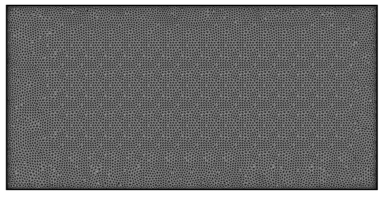

Figure 2. Mesh Used for Simulating Multiphase Sloshing Within a 2D Tank

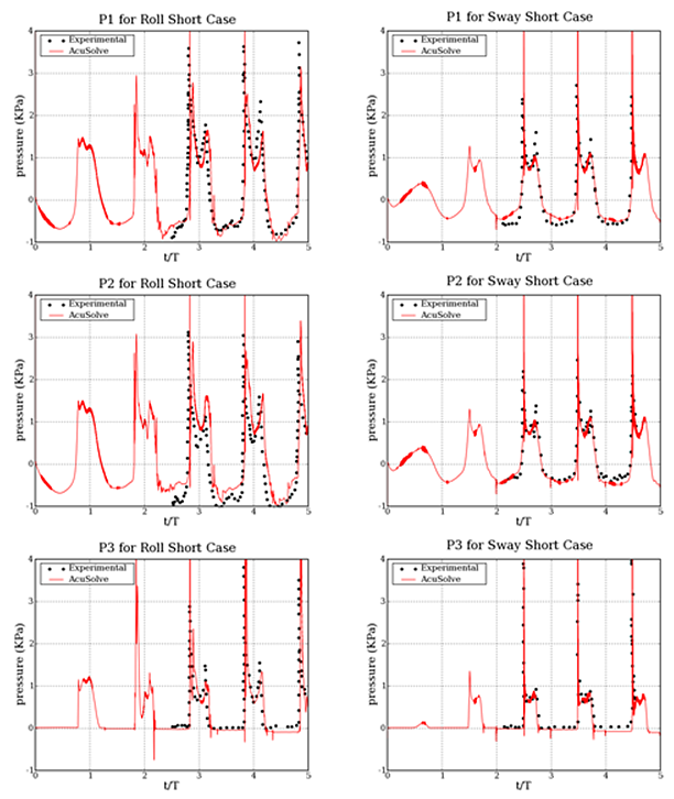

The AcuSolve solution is run for a time of t/T=5.0, 9.25 sec for Roll - Short, and the results presented reflect the transient motion of the water within the tank. The experimental values of pressure (kPa) and normalized simulation time are presented with the corresponding AcuSolve results at three measurement locations. The AcuSolve results show good agreement with the experimental results for pressure magnitude, the local water column height, as well as accurate timing of the peaks, indicating that the air-water interface is properly captured. Additional motion cases, as well as comparisons between two dimensional versus three dimensional simulations have been simulated with AcuSolve. The accuracy and solution requirements of these simulations are omitted for brevity but are available upon request. It was found that the differences between 2D and 3D simulations may be of interest for engineers, however the 2D results are shown to be adequate and less computationally expensive than 3D in the cases studied.

Figure 3. Time Dependent Pressure at Three Monitoring Locations Within the Sloshing Tank for Two Motion Profiles (Roll-Short, Left and Sway-Short, Right)

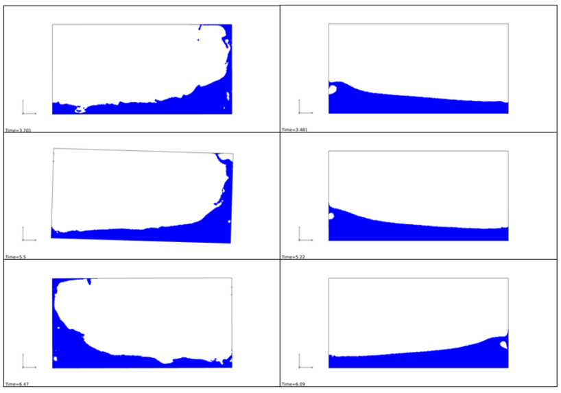

Figure 4. Instantaneous Volume Fraction Contour (Blue Showing Water) at Three Moments in Time (t/T=2.0, 3.0 and 3.5) for Two Motion Profiles (Roll-Short, Left and Sway-Short, Right)
