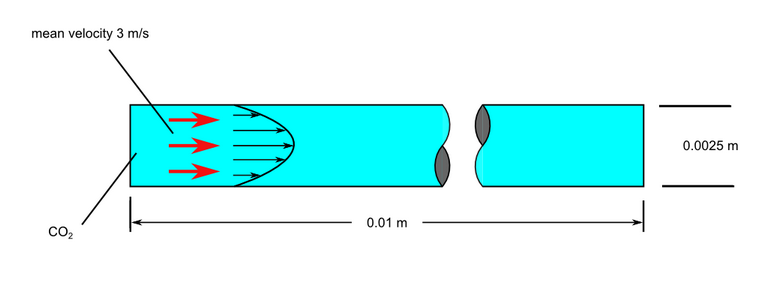

Problem Description
Figure 1. Critical Dimensions and Parameters for Simulating Laminar Poiseuille Flow Through a Pipe

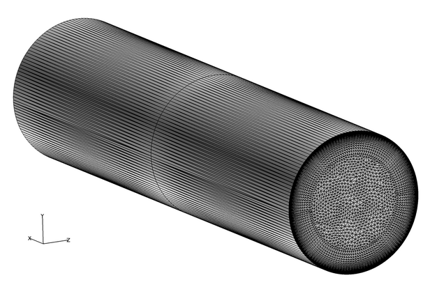

Figure 2. Mesh Used for Simulating Laminar Poiseuille Flow Through a Pipe

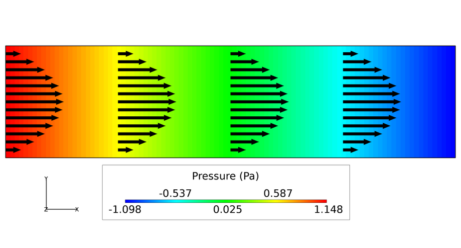

Figure 3. Pressure Contours and Velocity Vectors
| Analytical pressure drop (Pa) | AcuSolve pressure drop (Pa) | Percent deviation from analytical | |
| Inlet to outlet pressure drop | 2.242 | 2.245 | 0.099 |
Summary
The AcuSolve solution compares well with analytical results for laminar flow through a pipe. In this application, the pressure drop along the length of the pipe is caused by the viscous shearing near the pipe wall. The AcuSolve steady state solution compares well with the analytical solution, with less than 0.1 percent error.
