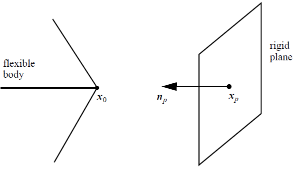

The parameter contact_constraints may be used to specify a set of contact conditions to be imposed on the time evolution of the flexible body. Only simple contact between a set of points attached to the flexible body with a set of fixed rigid planes is accommodated. Contact constraints are supported only with trapezoidal type. Contact introduces a strong nonlinearity on the linear model given above, and thus must be modeled with care.
Figure 1. Flexible Body Contact with a Rigid Plane
Note that yi, ci, and b are all scalar values.
Formally, the solution for the displacement of the flexible body with contact is the transient solution for y subject to the inequality constraints above. This system may be solved using the "interior point method" of "quadratic programming".
where
and
are the modal
velocities at time step n and n+1, respectively, and the contraction is over all of the
modes. The above equation approximately sets the
c component of modal velocity after contact
occurs to the negative of the corresponding modal velocity prior to contact scaled by
the restitution coefficient. Note that the restitution coefficient is between zero and
one; α = 0 models an inelastic collision, and α = 1 models a perfectly elastic collision. The formulation above is for one contact
constraint; AcuSolve supports any number of constraints.
The parameter contact_constraints is a two dimensional array with num_modes+2 columns, corresponding to the vector c (num_modes columns), the b value, and the restitution coefficient, α. Each row of the array corresponds to one contact constraint. This array is usually constructed using the contact_constraints_file option of AcuPev; see the AcuSolve Programs Reference Manual.
