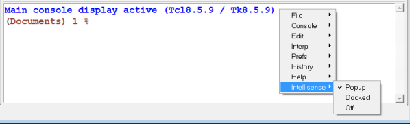

Display Modes

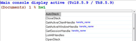

- Popup
- Popup displays the Tcl/Tk command names within the console, relative to the location of the last line of text in the window. Once you select an API when in popup mode, the Intellisense window is dismissed.

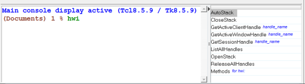

- Docked
- Docked displays the Tcl/Tk names on the right side of the console, as shown in the image below.

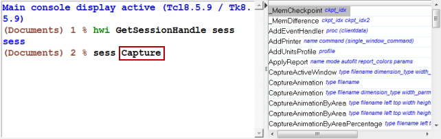

Variables are supported. When a valid handle is set to a variable, typing that variable name preceded by a dollar sign, $, invokes the Intellisense popup for that handle.

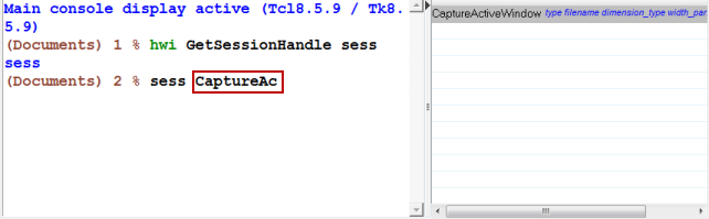

The more specific you are with the text you enter, the fewer choices are displayed, as shown in the two examples below.

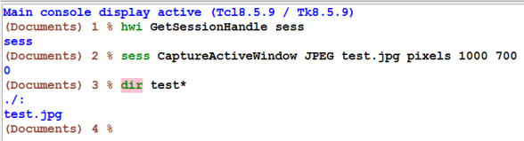

The file test.jpg is created.
