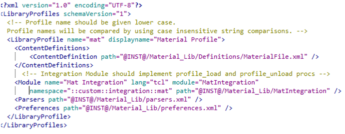

Update the librarypreferences.xml File
A typical profile consists of the following: Install.tcl: To install the profile, libraryprofiles.xml: Contains path to Content definitions, parsers and custom integration .tcl files, and Main folder: Contains custom scripts, content definition .xml files and parser .tcl files.

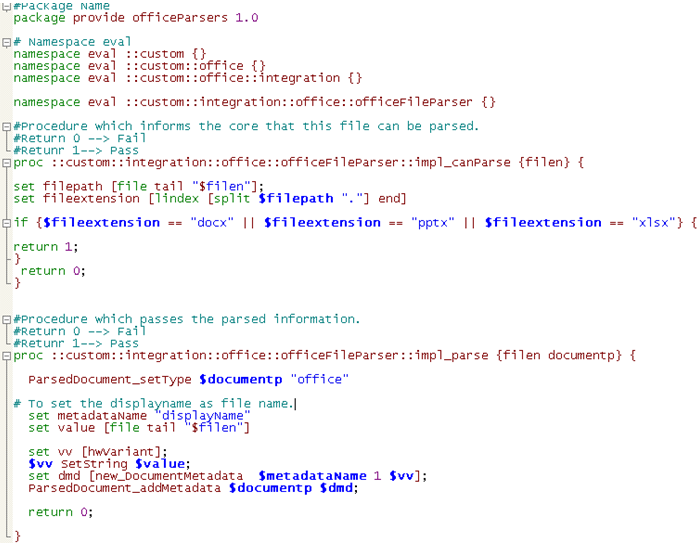

Parser Tcl Code
In the previous step you edited the parser.xml file to point to the appropriate Tcl code. Now you will take a look at the parser Tcl code. For simplicity the start package code does not need any editing.

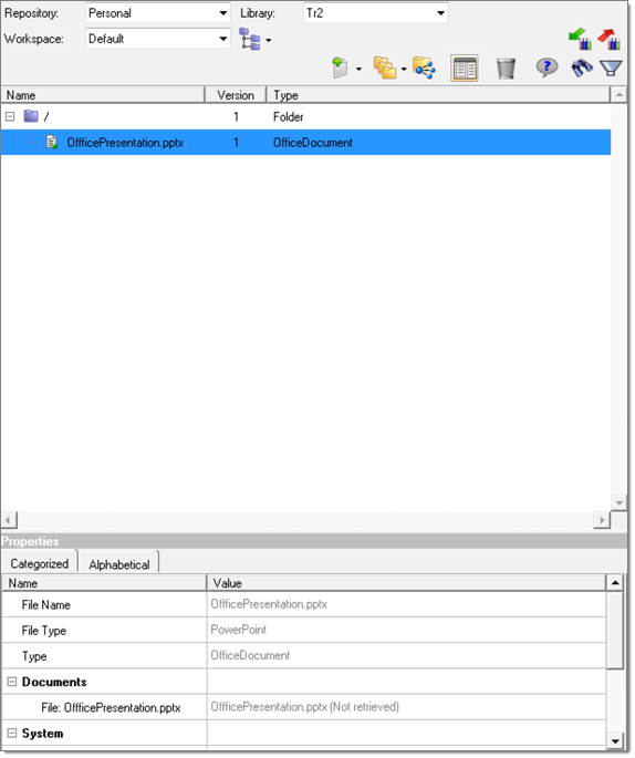

Add a New Content to the Office Library
In the previous step you created a new library using the Office profile. Now you will add a PowerPoint document to this library.
View the Custom Context Menu
Now you will review the action of adding a new custom context menu.
