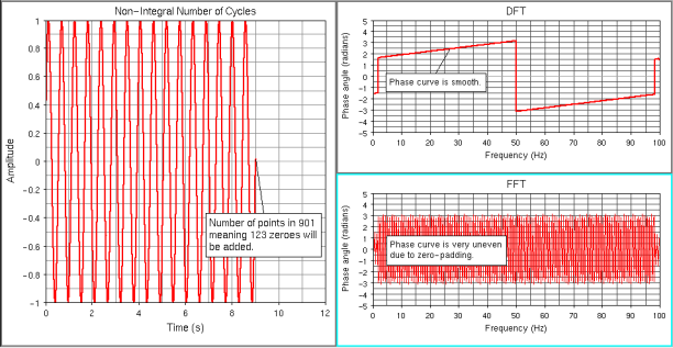

A Fast Fourier Transform (FFT) is a computationally efficient algorithm for
evaluating the Fourier Transform equation. The only additional requirement is that
the input signal have a number of points equal to two raised to some integral power:
i.e., 256 (28), 512 (29), and so on. If the input signal does
not have a valid number of points, zeros are added at the end of the signal until a
valid number of points is reached. This is called zero-padding. Figure 1. Discrete Fourier Transform and Fast Fourier Transform
HyperView, MotionView, and
HyperGraph have both a regular discrete Fourier
Transform and a Fast Fourier Transform. The advantage of the discrete Fourier
Transform is that no zero-padding occurs. This is important because zero-padding can
distort the phase angle spectrum. The advantage of the Fast Fourier Transform is in
computation speed, which varies with the number of points.

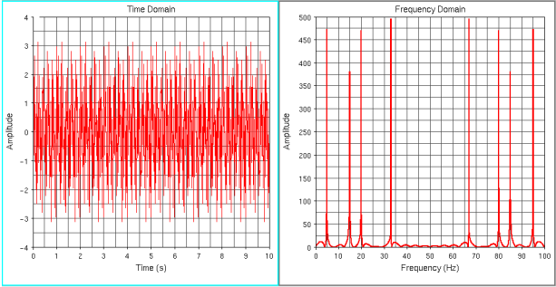

For example, in HyperGraph, create the following
curve:
Now
create a second curve in a different window on the same page. It should
be:
x=freq(p1w1c1.x)
y=FFTmag(p1w1c1.y)
The result shows spikes at each of the frequencies present in the initial equation,
that is: at 5 Hz, 15 Hz, 20 Hz, and 33 Hz.
Notice that there will also be other spikes at frequencies not present in the initial
equation, at 67 Hz, 80 Hz, 85 Hz, 95 Hz. This is due to phenomena caused by sampling
the data, and is discussed below.
Since the right half of the spectrum is essentially redundant, the left half is
normally all that is plotted. HyperGraph accounts for
this using the fold function. The right half of the spectrum is folded back onto the
left half. In the previous example, replace the y equation
with:
y = fold(FFTmag(p1w1c1.y))
Only the left half of the spectrum is shown.

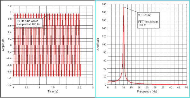

Aliasing
Due to the nature of sampled data, only a limited frequency range can be
examined using discrete Fourier transforms. The valid frequency range is
from 0 to half of the sampling frequency. This is known as the Nyquist
frequency. Any frequencies outside of this range are erroneously
attributed to frequencies inside the range. These frequencies will be
"folded" back into the valid range. Figure 3.
For example, a curve has a frequency content at 90 Hz and is sampled at
100 Hz. The Nyquist frequency is then 50 Hz. Since 90 Hz is greater than
50 Hz, it will be folded about the Nyquist frequency back into the valid
range of 0-50 Hz. Therefore, it will be mapped to 10 Hz, as well as 90
Hz (and 110 Hz, 190 Hz, ...). The spectrum is always symmetric about the
Nyquist frequency, as seen in the above example.

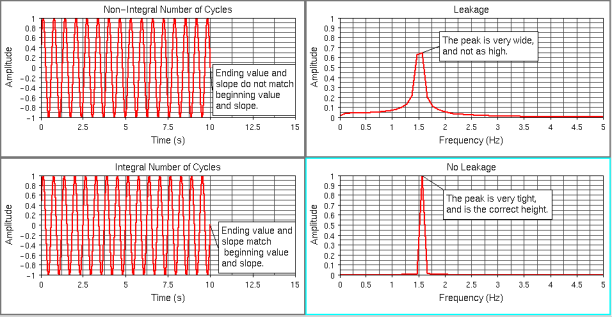

Leakage
An assumption made by the Fourier Transform is that the signal being
transformed is periodic, allowing the integral in Equation 1 to go from
0 to the signal duration rather than from 0 to infinity. This means
that, in effect, the FT algorithm is concatenating the signal with
itself indefinitely. At the endpoints of the signal, discontinuities
often occur. These discontinuities are very difficult to map to periodic
components. In fact, they require an infinite number of periodic
components. This, in turn, introduces spurious frequency components into
the resultant spectrum. Figure 4.
The most common method used to reduce leakage is to use data
windowing.

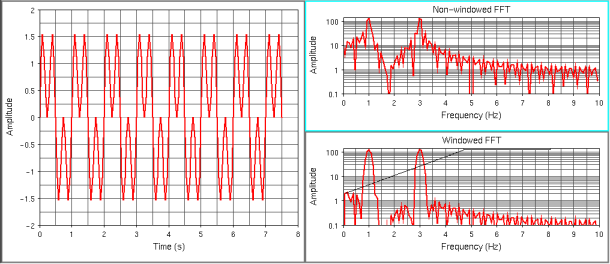

As described in the previous section, discontinuities at the end points of the signal
introduce leakage. Leakage is undesirable because it distorts the true spectral
characteristics of the signal. To eliminate leakage, not only must the end points of
the signal have the same value, but they must also have the same slope.
The most common way to reduce leakage is by using windowing functions. A sample
windowing function is shown below. The sample shows the Hamming window function. Figure 5.
The value of the windowing function starts out very small, increases to a value of
one in the middle, and then decreases symmetrically. When this function is
multiplied by the input signal, it has the effect of damping out the ends of the
signal. Thus, when the signal is concatenated with itself, no large discontinuities
will be present since the end points should both have values and slopes close to
zero.
Using a windowing function, however, alters the quantitative properties of a signal,
such as the RMS. HyperGraph uses power correction in its
windowing functions to eliminate this problem. HyperGraph also removes the mean (DC component) from the signal before windowing. This makes
the windowing more effective and does not affect the frequency content of the
signal.

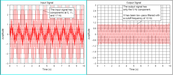

Filtering
A common practice in signal processing is to smooth data by eliminating
high-frequency components. This is done using a low-pass filter. It is called a
low-pass filter because it only keeps low-frequency components and eliminates high
frequency components. Thus, it only lets low-frequency components pass. Other types
of filters are high-pass, band-pass, and band-stop, or notch, filters.
In order to filter a signal, the application transforms the input data into the
frequency domain using an FFT. All unwanted frequency components are eliminated by
multiplying the FFT values at these frequencies by zero. The modified frequency
domain data is then transformed back into the time-domain. Figure 6. Low-Pass Filtered Signal
In order to specify which frequencies are to be removed, cutoff frequencies must be
defined. For low- and high-pass filters, only a single cutoff frequency is
necessary. For low-pass filters, frequencies below the cutoff frequency are passed,
while the opposite is true for high-pass filters. Band-pass and band-stop filters
require two cutoff frequencies, a low and a high. For a band-pass filter, only
frequencies between the two cutoff frequencies are passed, while for a band-stop
filter, only frequencies outside this range are passed.

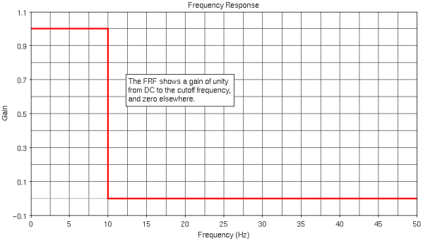

Frequency Response Functions
A Frequency Response Function, FRF, is used to determine the frequency
characteristics of a given system. The system must be quantified with an input
signal and an output signal.
The result of the FRF is a complex-valued function. Normally this is also shown in
magnitude/phase form. The magnitude spectrum gives information as to the system gain
at various frequencies, while the phase spectrum gives delay information. Figure 7.
For a system with a uniform gain and delay, the magnitude spectrum would be constant
at the gain of the system and the phase spectrum would be linear with slope
proportional to the system delay.

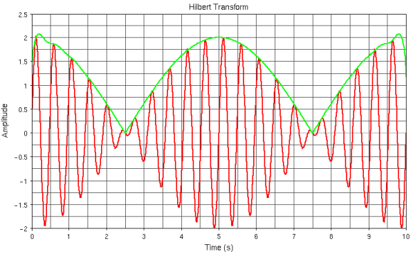

Hilbert Transform
The Hilbert Transform is used to obtain the envelope of a curve. It is in fact
guaranteed to be greater than or equal to the input signal for all data which is
functional, i.e.: the X values are monotonic or strictly increasing. It is done
using a complex algorithm incorporating FFTs. It tends to work very well with smooth
curves, but for noisy data the results are not as good. Also, as with
frequency-domain filtering, the beginning and end of the signal tend not to match
the original data very closely. Figure 8.
