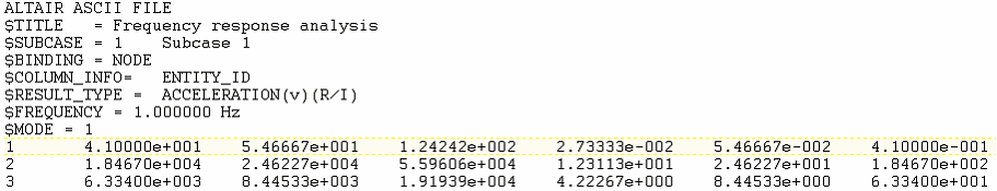

- The extension of the file containing the ASCII data is recommended to be *.hwascii. Other file extensions are allowed, however the filter in the File Open dialog is set to look for *.hwascii files.
- The first line in the ASCII file must contain "ALTAIR ASCII FILE" in header (which identifies the file type).

- Number of data values for each of the result types (mandatory):- RES(v) 3 (6 for complex results)
- RES(t) 6 (12 for complex results)
- RES(2t) 3 (6 for complex results)
- RES(s) 1 (2 for complex results)
- The order of data for each of the result types:- Vector – X,Y,Z.
- Tensor – XX,YY,ZZ,XY,YZ,ZX.
- Complex – Real (Mag) values for all the components followed by Imaginary (Phase) values.

- If GRID_ID is specified in the header, the Result Data is repeated at each node (or corner nodes) of the Element. When specifying the corner data, the grid ID or the corner index must match the order of the connectivity of the element. Mixing the order can result in undesirable data being associated to the corners.

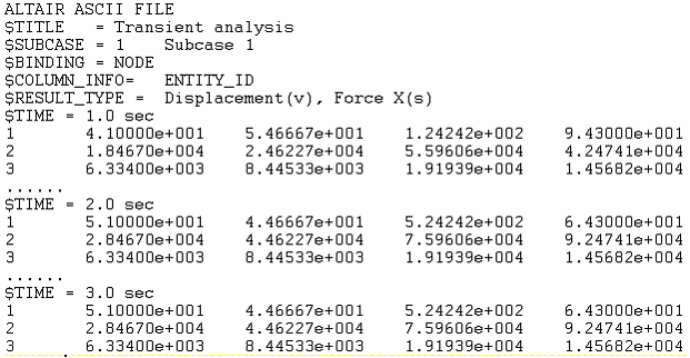

- If the units for $FREQUENCY (or $TIME) is to be provided, then it has to be given after the sync value (separated with a space).
- If $SUBCASE and $FREQUENCY (or $TIME) is not specified, then it is a static analysis in one subcase.
