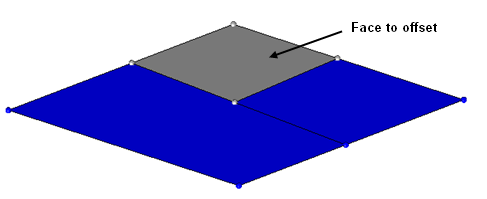

- copy_faces
- The flag that specifies whether original faces are preserved. This member can have one of following values:

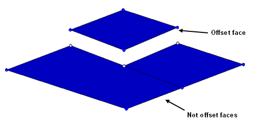

HM_OFFSET_MODE_DISCONNECT - Offset faces are disconnected from faces that are not offset or offset a different distance. This corresponds to the "disjoint offset" option in surface edit->offset subpanel.

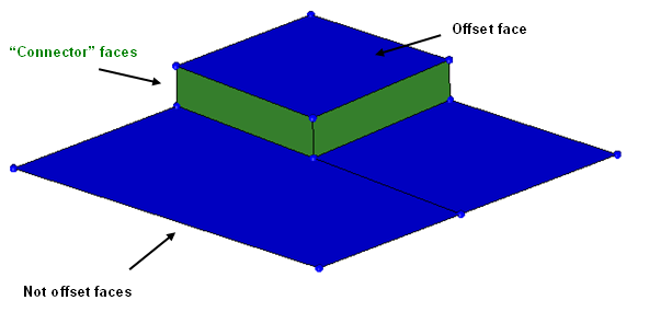

HM_OFFSET_MODE_CONNECT - Connector faces are created to preserve continuity between offset faces and faces that are not offset or offset a different distance. This corresponds to the "continuous offset" option in surface edit->offset subpanel with "separator lines" selected for all edges of the offset faces connected to faces that are not offset.
Figure 3.

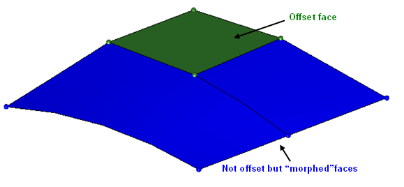

HM_OFFSET_MODE_INF - Connected to offset faces that are not offset or offset a different distance are "morphed" continuously to preserve continuity. This is known as "infinite smooth radius" mode. Note that if faces are offset to different distances then in this mode the faces with the largest offset distance are offset last, so the faces connected to them are "morphed" and after that "morphing" are not offset exactly to the distance specified for them.
Figure 4.

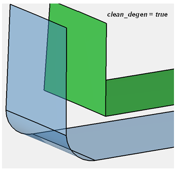

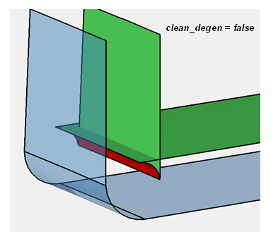

- clean_degen
- The flag that specifies whether additional check and cleanup should be done for possible degeneracies of the faces resulting from the offset to large distances.
true - Additional checking and cleanup of degeneracies are done.
Note that setting this to true can significantly slow down overall performance of the offset function. It is therefore recommended to set this option to false for large models with relatively small offset distance values.
