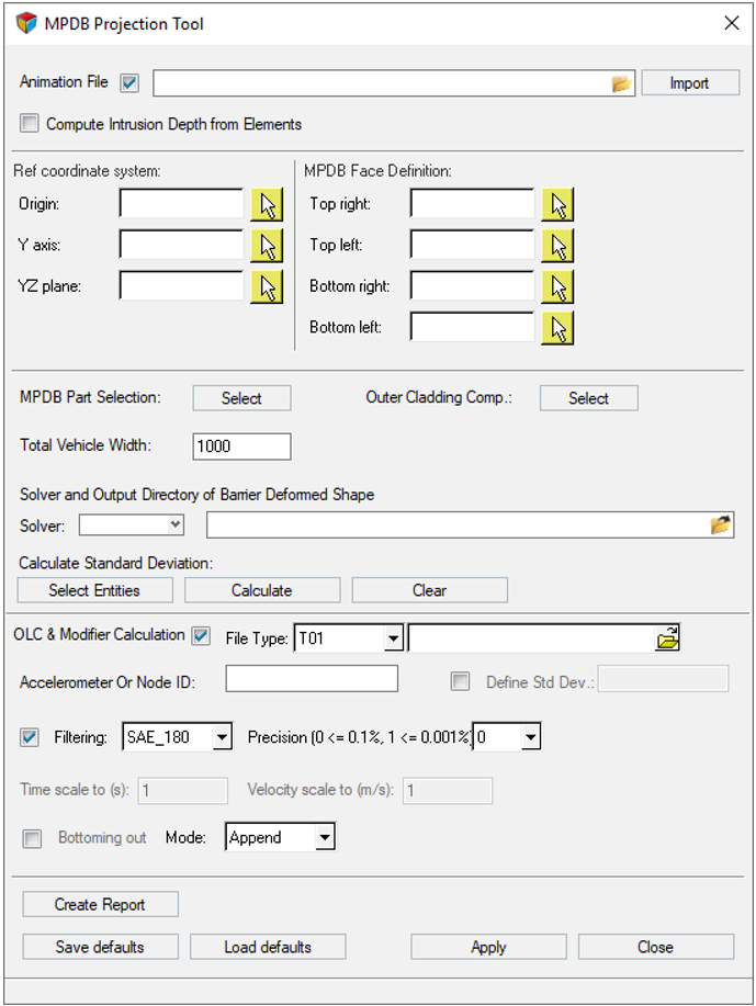

The MPDB tool offers a complete automated post processing solution of the MPDB Frontal Compatibility Assessment load case, for Radioss and LS-DYNA output files.

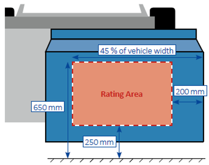

Figure 1. Figure from Carhs Safety Companion 2019
Figure 3.

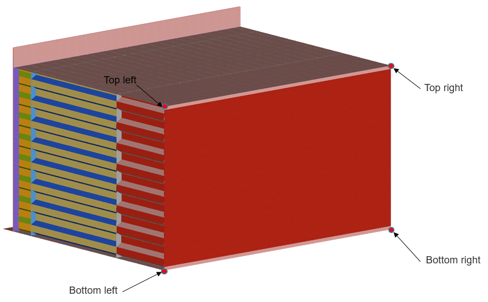

- The definition of the rating area of the PDB front face
- The calculation of the standard deviation of the post-test barrier deformation
- The calculation of the Occupant Load Criterion (OLC)
- The calculation of the Compatibility Modifier
- Results report generation

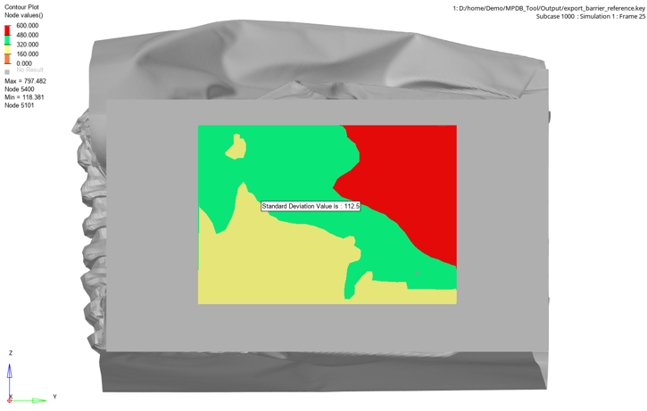

Calculate the Standard Deviation

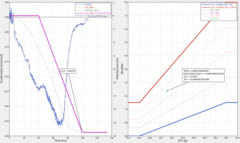

Calculate the OLC and Modifier

MPDB Tool Results
