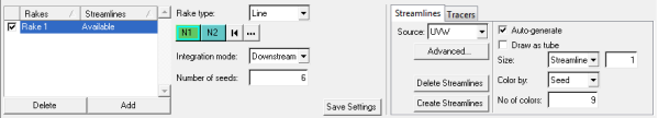

Streamlines
Use the Streamlines tool to generate streamlines using any available nodal or elemental vector field (typically a velocity field).

Figure 1. Streamlines Panel
