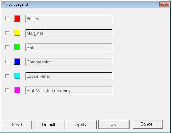

Edit the Legend Properties
From the FLD tab, click Edit
Legend.
The Edit Legend dialog is displayed.
Figure 1. FLD Panel Edit Legend Dialog -
Click in the check box next to a legend attribute in order to activate the
color and text box for that attribute.
- To change the color, click on the color box and select a new color from the color palette.
- To rename a legend attribute, click inside the text box and type in a new name.
Select from the options available at the bottom of the dialog.
Save Save the current legend settings to a Tcl file, which can be used in preferences. Default Reset the default legend properties. Apply Apply the changes made to the legend. OK Apply the changes and exit the dialog. Cancel Disregard changes and exit the dialog.
