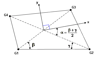

Figure 1. Method 1- The origin of the coordinate system is located at the centroid of the element.
- x is along a line that bisects the angles between G2-G4 and G1-G3.
- y is perpendicular to x as shown in the figure.

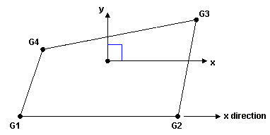

Figure 2. Method 2- The origin of the coordinate system is located at the centroid of the element.
- x is along the G1-G2 line.
- y is perpendicular to x.

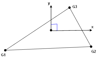

- Tria3/Tria6
Figure 3.- The origin of the coordinate system is located at the centroid of the element.

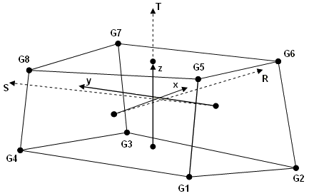

- Hexa8/Hexa20
- The element coordinate system for the Hexa element is defined in terms of the three
vectors R, S, and T, which join the centroids of opposite faces, as follows:
- R vector joins the centroids of faces G4-G1-G5-G8 and G3-G2-G6-G7.
- S vector joins the centroids of faces G1-G2-G6-G5 and G4-G3-G7-G8.
- T vector joins the centroids of faces G1-G2-G3-G4 and G5-G6-G7-G8.
The origin of the coordinate system is located at the centroid of the element. The axes are derived as follows:- z = T
- y = T x R
- x = y x z
Figure 4. - Tetra

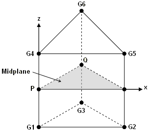

Figure 5. - Penta
- The element coordinate system for the Penta element is derived accordingly. A midplane
is formed by the three midpoints of the straight lines between the top (G1-G2-G3) and
bottom (G4-G5-G6) triangular faces. The origin of the coordinate system is located at
the centroid of the element. The axes are formed as follows:
- z = A line along the bisector of the midplane normal and the line connecting the centroids of the top (G1-G2-G3) and bottom (G4-G5-G6) faces.
- y = The vector connecting points P and Q where P and Q are defined as
follows:
P = The midpoint along the line, G1-G4. In order to define Q, you must define a plane that passes through P and is perpendicular to axis z.
Q = The intersection of the plane defined above and the line G3-G6. - x = The intersection of the plane defined above and the line G3-G6.
Figure 6.
