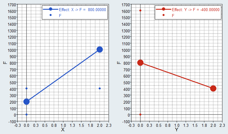

Example: Linear Effects
For two-level design of experiments, linear effect values can also be calculated as the difference between the average output responses when the input variable is at its lower value and when the input variable is at its upper value.
| Run | X | Y | F(X,Y) |
| 1 | 0 | 0 | 1 |
| 2 | 0 | 2 | 401 |
| 3 | 2 | 0 | 1601 |
| 4 | 2 | 2 | 401 |
- When X is at lower level, the mean output response is (1 + 401) / 2 = 201
- When X is at upper level, the mean output response is (1601 +401) / 2 = 1001
- The effect of X on F is then (1001 - 201) = 800
- When Y is at lower level, the mean output response is (1 + 1601) / 2 = 801
- When Y is at upper level, the mean output response is (401 + 401) / 2 = 401
- The effect of Y on F is then (401 - 801) = -400
Figure 1. Linear Effects Plot
