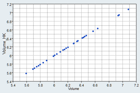

Commonly called the coefficient of determination, is a measure of how
well the Fit can reproduce known data points. Graphically, this can be
visualized by scatter plotting the known values versus the predicted
values. If the model perfectly predicts the known values, R-Square will
have its maximum possible value of 1.0, and the scatter points will lie
on a perfect diagonal line, as shown in the Figure 1. Figure 1.
