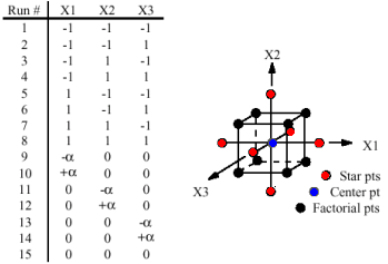

Figure 2. Generation of a Central Composite Design for Three Factors

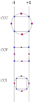

| CCD Type | Terminology | Definition |
| Circumscribed | CCC | Designs are the original form of the central composite design. The star points are at some distance α from the center, based on the properties desired for the design and the number of factors in the design. The star points establish new extremes for the low and high settings for all factors. These designs have circular, spherical, or hyperspherical symmetry and require five levels for each variable. Augmenting an existing factorial or resolution V fractional factorial design with star points can produce this design. |
| Inscribed | CCI | Uses the variable settings as the star points and creates a
factorial or fractional factorial design within those limits (in
other words, a CCI design is a scaled down CCC design with each
variable level of the CCC design altered to generate the CCI
design). This design also requires five levels of each
variable. Note: Used for situations in which the limits
specified for variable settings are truly
limited.
| Face Centered | CCF |
The star points are at the center of each face of the factorial space, so α = ± 1. This variety requires three levels of each variable. Augmenting an existing factorial or resolution V design with appropriate star points can also produce this design. |
Figure 3. Comparison of the Different Types of Central Composite Designs
The Box Behnken design and the CCF Central Composite Design can be visualized as near compliments of each other. They both essentially suppress selected runs from a Full Factorial matrix in an attempt to maintain the higher order surface definition. For example, for three three-level variables, the Full Factorial run size is 27. The central composite plan drops all of the middle edge nodes, resulting in only fifteen runs. The Box Behnken design is nearly the opposite in that it uses the twelve middle edge nodes and the center node to fit a 2nd order equation. Central Composite Design plus Box Behnken becomes a Full Factorial with extra samples taken at the center.
