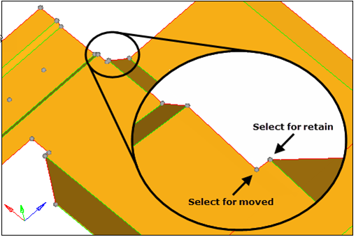

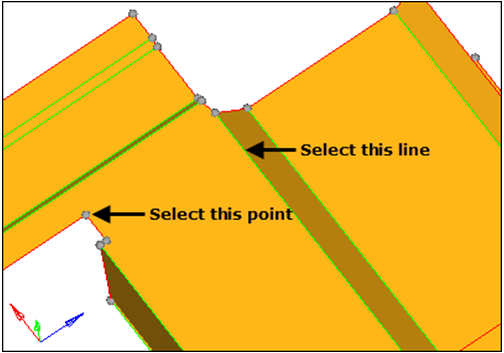

Remove Short Edges
In this step you will remove short edges by combining fixed points.

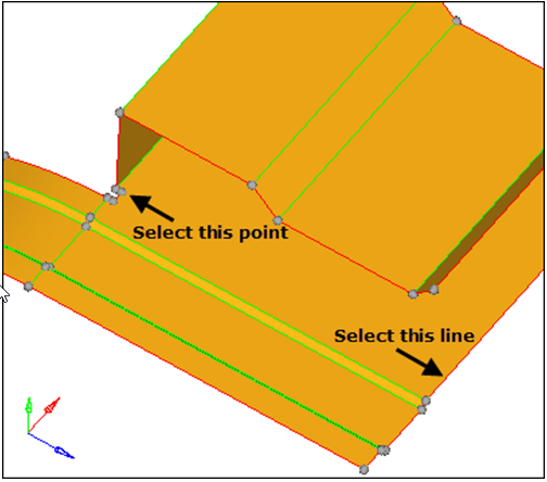

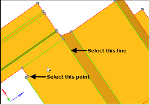

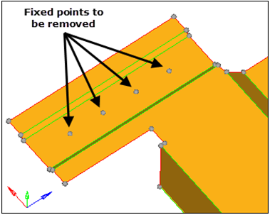

Remove Fixed Points
In this step you will remove the fixed points interior to all surfaces.
You should still be in the Points panel.

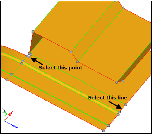

Add Edges to Control the Mesh Pattern
In this step you will add edges to the surfaces to control the mesh pattern.

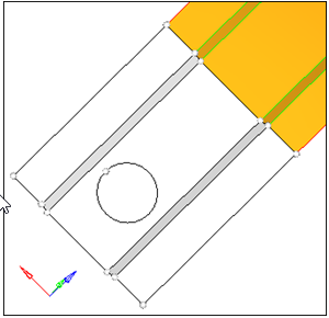

Add Edges to Surfaces
In this step you will continue to add edges to surfaces to control the mesh pattern.

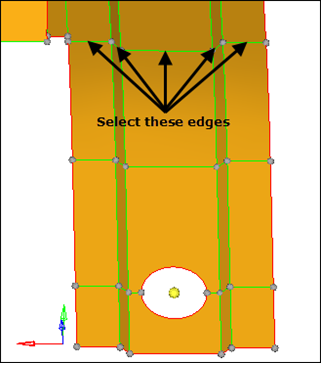

Suppress Shared Edges
In this step you will suppress shared edges causing a small edge.

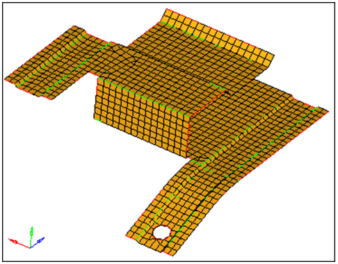

Remesh the Part
In this step you will remesh the surfaces of the part using the automatic mode, a size of 2.5, and the mixed mesh type.
In the Model Browser, Component folder, click
next to Middle Surface to display its elements.
- To open the Automesh panel, click from the menu bar, or press F12.
- Verify that elem size = is set to 2.5 and the mesh type is set to mixed.
- To select all displayed surfaces, click surfs >> displayed.
- Click mesh.
