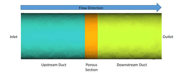

The problem to be addressed in this tutorial is shown schematically in the figure below. It consists of a cylindrical channel with a porous medium in the flow section. As the flow passes through this section, a pressure drop is observed. In this simulation, an inlet velocity will be assigned to the flow and pressure drop across the porous medium will be calculated. The length of the porous section is 0.06 m and the fluid is an imaginary air-like fluid with a density of 1 kg/m3 and a molecular viscosity of 0.001 kg/m-s. The inlet velocity of the flow is 0.2 m/s.

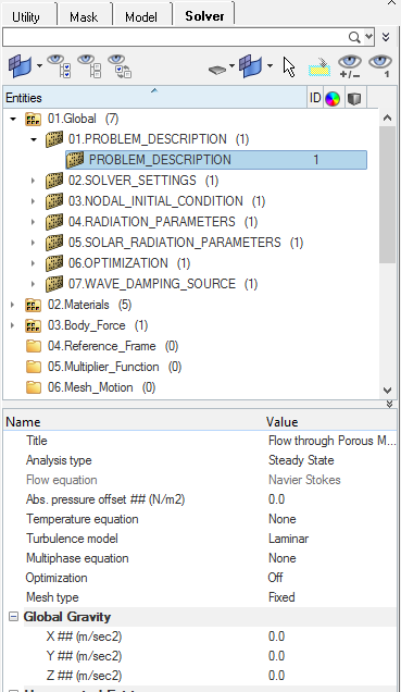

In this step, you will set the simulation parameters that apply globally to the simulation.

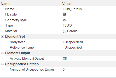

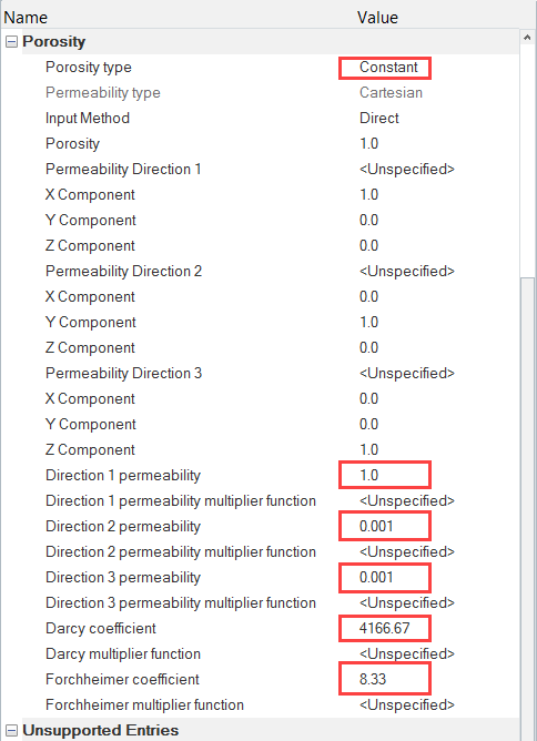

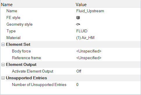

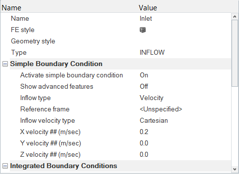

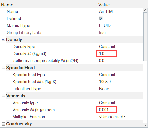

In this step, you will start by modifying the material properties of Air and then create a material model for the porous medium. Then, you will assign the surface boundary conditions and material properties for all the fluid volumes.
Create the Material Model

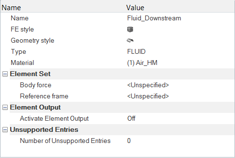

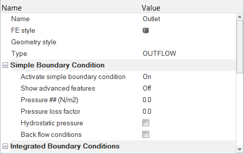

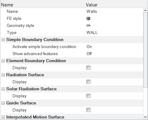

Assign Boundary Conditions and Material Properties

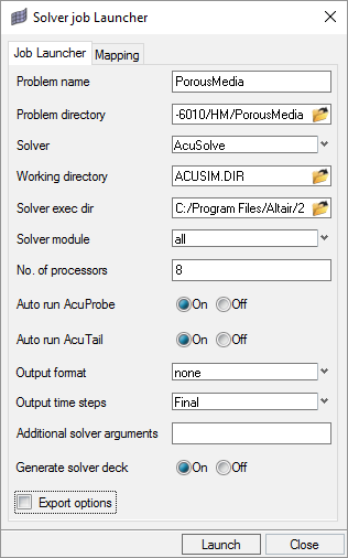

Compute the Solution
In this step, you will launch AcuSolve directly from HyperMesh and compute the solution.

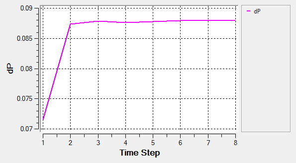

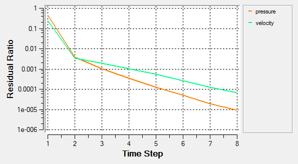

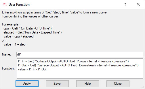

As the solution progresses, AcuProbe is launched automatically. AcuProbe can be used to monitor different variables over solution time. In this step, you will plot the residual ratio values and then compute the pressure drop across the porous section.
Summary

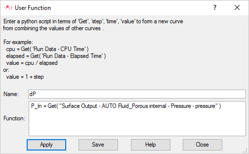

In this tutorial, you learned how to set up and solve a problem with porous medium. You started by importing the HyperMesh database and then creating a material model for the porous section. Then, you assigned the boundary conditions and material properties and solved by launching AcuSolve directly from HyperMesh. Finally, you created a pressure drop plot using the user function tool in AcuProbe and calculated the drop in pressure between the inlet and outlet surfaces of the porous section.
