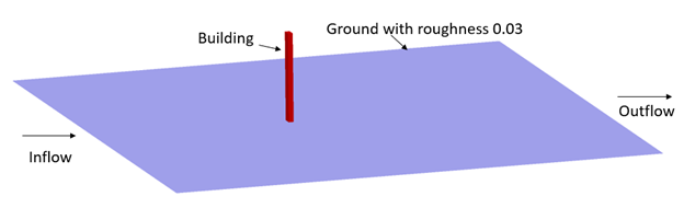

The problem to be addressed in this tutorial is shown schematically in Figure 1. As an example, this problem shows the capability of Atmospheric Boundary Layer modelling in AcuSolve.

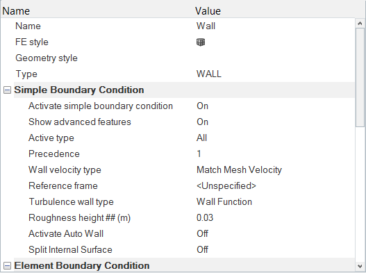

In this tutorial, you will simulate the air flow over a building with a ground roughness of 0.03. In this case, User Defined Atmospheric Roughness Type is considered.

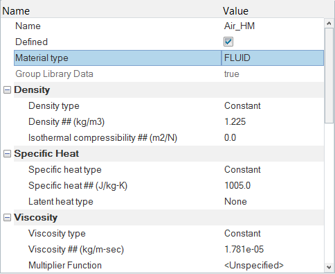

In this step, you will define the Boundary Conditions (BCs) for the problem and assign material properties to the fluid volume.
Set Up Material Model Parameters

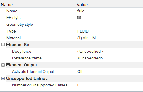

Set Up Fluid Volume Material

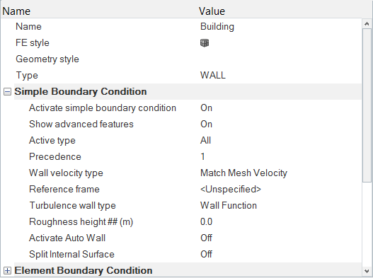

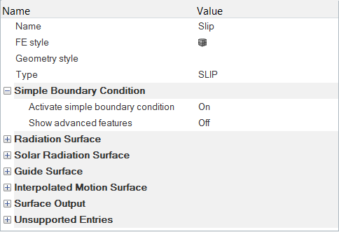

Set Up Boundary Conditions

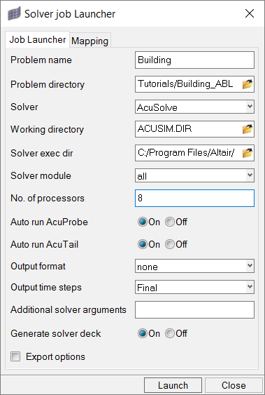

In this step, you will launch AcuSolve directly from HyperMesh and compute the solution.
Run AcuSolve

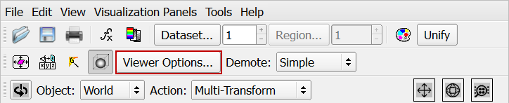

Click on the AcuFieldView icon
to launch the
AcuFieldView
dialog.

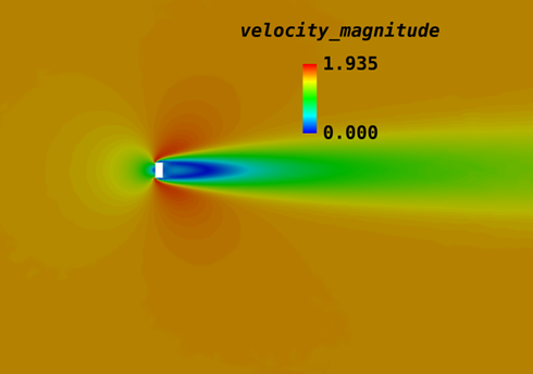

Coordinate the Surface for Showing Velocity Magnitude on the Y Plane

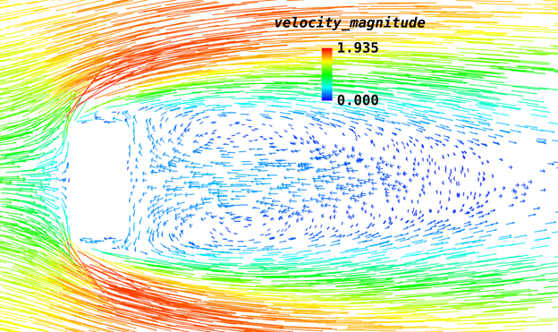

Coordinate the Surface for Showing Velocity Vectors on the Y Plane
Coordinate the Surface for Showing Velocity Magnitude on the Z Plane
Coordinate the Surface for Showing Velocity Vectors on the Z Plane
