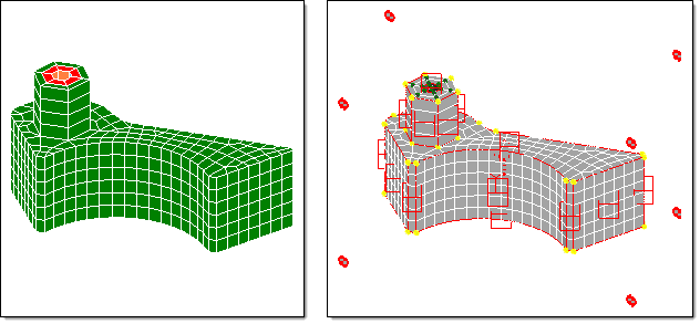

Figure 1. 3D Domain Created for Solid Model. The automatic creation and partitioning of 2D domains on the face of the solid and the creation of edge domains and handles for the 2D domains.

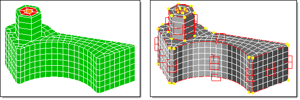

Figure 2. Automatic Generation of Domains on Solid Model. The addition of a global domain, global handles, and 1D domain, which produces dependent (green) handles.

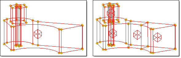

Figure 3. 3D Domain Split into Four 3D Domains. The influences of the handles will not extend across the boundaries between the domains.
Influences must be recalculated every time handles, domains, or symmetries are added, edited, or deleted. They are also recalculated during radius changes and geometry mapping. These calculations occur when you enter or leave a HyperMorph panel or when you leave the delete panel. For large models you will want to make all of your domain changes before exiting the Domains panel. The influences for handles are only recalculated in regions that have been edited.

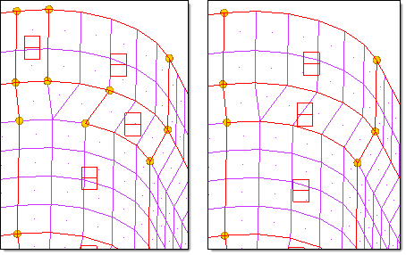

Figure 4. Move Elements. The model on the left shows problems that partitioning can encounter for some meshes. The model on the right has been corrected using the organize subpanel of the Domains panel. For this example, the retain handles option was left unchecked, resulting in the elimination of handles that are no longer on the corners of the 2D domains.

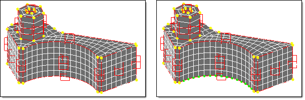

Figure 5. Split Edge Domains. The lower edge domain has been split at the gray node (left model), which becomes a handle (right model). Now the radius of each new edge domain may be modified independently of the other.
