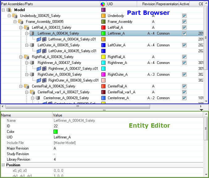

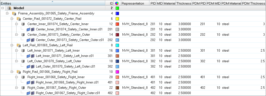

All BOM-related information, including part/assembly hierarchy, part attributes, and representation information is organized and displayed in the Part Browser.
Representation (HyperMesh session) attributes are now displayed independent of the PDM attributes. Attribute columns can be turned on/off in the Column Visibility dialog, which can be accessed by right-clicking in the Part Browser and selecting Column Visibility from the context menu.

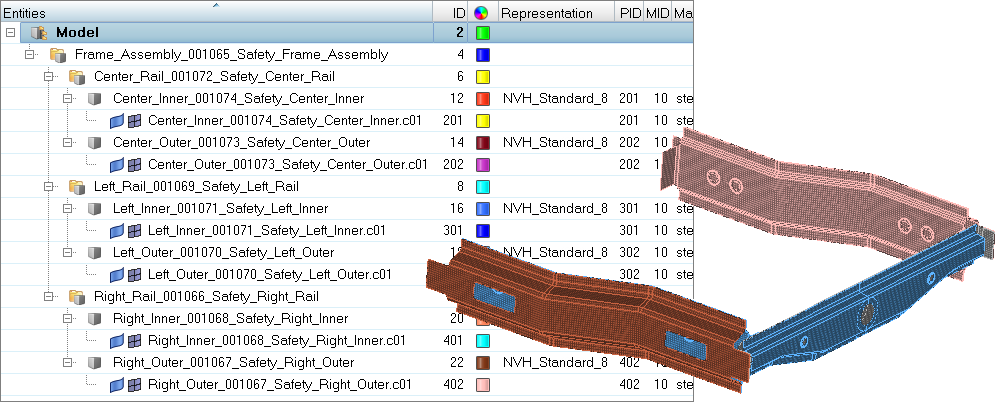

InFigure 1, the session attributes (PID, MID, Material, Thickness) are blank because representations have yet to be created or loaded. The corresponding PDM attributes, from the imported PLMXML BOM file, show their values from Teamcenter.

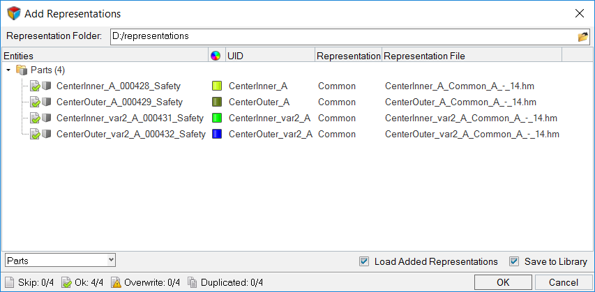

| Add | Adds representations for selected part(s) based on the chosen alias and file
type or from the Part Library. When adding representations for multiple parts or
part assemblies from external sources, the Add
Representations dialog enables you to map and associate
representation files to multiple parts simultaneously.
![]() Figure 2. If appropriate metadata is available in the BOM, then the alias values will be preselected. After choosing a Representation Folder, representation files will be mapped according to the Teamcenter naming convention. You can then manually select or update any of the alias and representation file values. Indicators are displayed for each part to

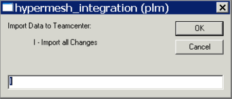

If HyperMesh was launched via the Teamcenter - HyperMesh Integration, you will be prompted to import updated data back to Teamcenter.
Figure 3.

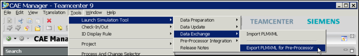

Update Teamcenter via Manual PLMXML Import in Teamcenter
If the BOM was loaded manually, for example HyperMesh was not launched via the Teamcenter-HyperMesh Integration, then the updated PLMXML package can be manually imported into Teamcenter.

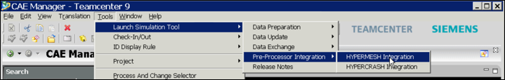

Import BOMs in HyperMesh via Teamcenter - HyperMesh Integration
Figure 5.

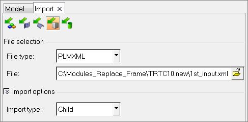

Import BOMs in HyperMesh via the HyperMesh Import - BOM Tab
The BOM is displayed in the Part Browser.

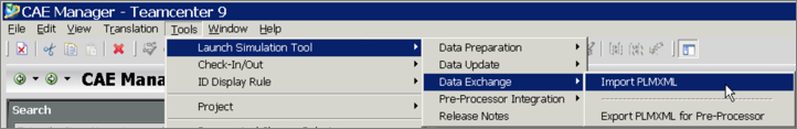

Figure 8.

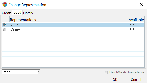

Load part representations from your current Teamcenter-HyperMesh or from the Part Library.
When CAD representations are loaded, components are created for the loaded CAD representations. Materials and properties, if available in the CAD file would also be created, and their values would be displayed in the Part Browser columns. Component naming conventions are not yet imposed, nor are the materials and properties created automatically at this time, therefore you can review information within the CAD files themselves prior to mesh representation creation. According to the Teamcenter-HyperMesh naming conventions, component naming and material and property handling will occur during the meshing process.
Load Representations from Current HyperMesh Session

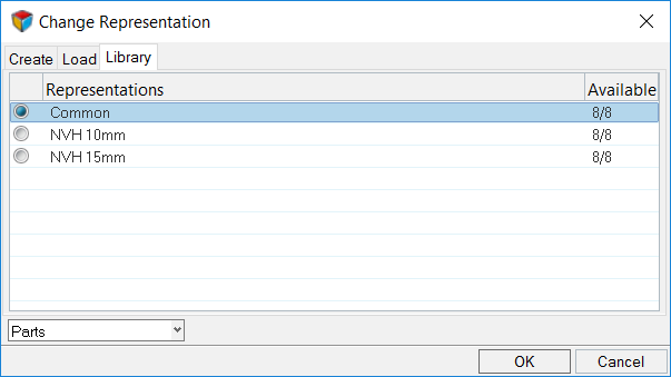

Load Representations from the Part Library
After importing a BOM that has representations saved in the Part library, you can load the saved representations.

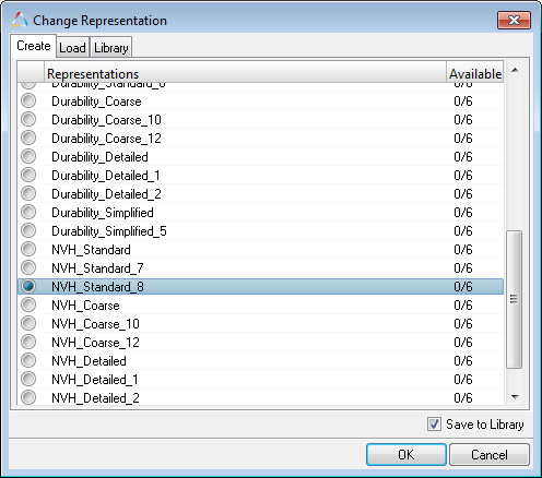

- In the Part Browser, right-click on a part/part assembly and select from the context menu.
- In the Change Representation dialog, Library tab, select representations and click OK.
Figure 12.
