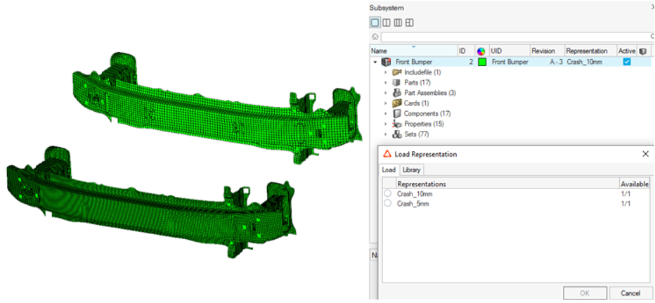

Subsystem representations allow a single subsystem to have multiple CAE representations that can be loaded into the session interchangeably.
For example, for front crash analysis you will want greater model fidelity in the front bumper, so you can load ‘Crash_5mm’ representation versus loading in ‘Crash_10mm’ representation when assembling a rear crash model where the increased level of detail is not required.

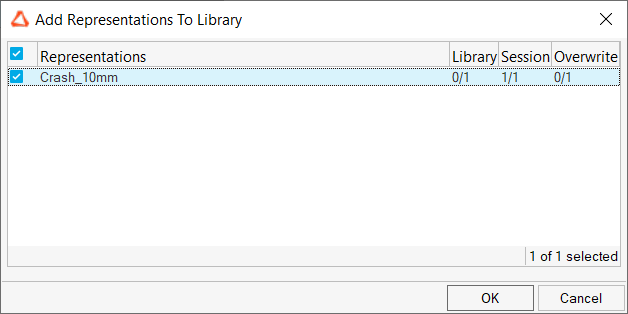

Add Representations to the Subsystem Library
Add representations to the library if they are in session.

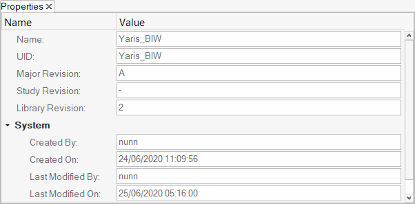

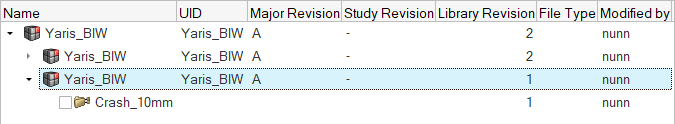

Browse Subsystem Library Content
Use the Library Viewer to review subsystem library content.
