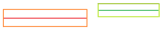

To consider the edge effects of thickness, select the Include edge
effects checkbox.
Figure 1. Include Edge Effects On
By default, the edge effects of thickness are not considered. Figure 2. Include Edge Effects Off
