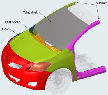

- Parts selection

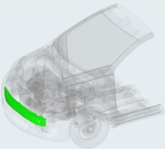

Figure 1. Vehicle Outer Surfaces- Bumper Beam: If leg form impact points must be created, select the Bumper Beam
components.
Figure 2. Bumper Beam Components
components.

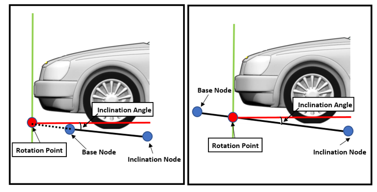

- Vehicle Inclination: For the marking process, you must define the ground level, which
gives the reference level of the construction lines. Below are the different options
that are available.
- Ground Type
- Flat: The ground is flat with normal in Z direction. You can specify the Z distance manually or select a node on the graphic.

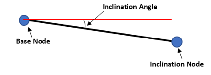

- Inclined: The ground level can be specified by selecting two nodes or
providing coordinates manually for Base node and Inclination node. The rotation
of the ground is then automatically calculated based on the coordinates of the
nodes.
- Inclination Type: Base Node: The rotation is calculated around the
provided base node.
Figure 3. Inclination Type = Base Node - Inclination Type: Forward Rotation: The rotation point position is
automatically defined on the front of the vehicle.
Figure 4. Inclination Type = Forward Rotation
provided base node.

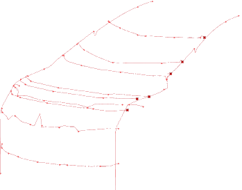

- Created Marking Entities: The Pedestrian Impact tool automatically generates:
- Marked entities(EuroNCAP)
- Wrap Around Distances lines (WADs)
- Left and Right Bonnet Side Reference lines (LSR and RSR)
- Bonnet Leading Edge (BLE)
- Bonnet Rear Reference Line (BRRL)
- Upper Bumper Reference line (UBR)
- Lower Bumper Reference line (LBR)
- Internal Bumper Reference line (IBR)
Figure 5. Marked Entities

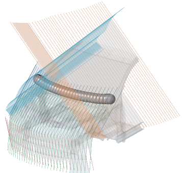

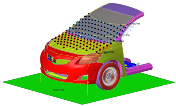

- Construction lines and spheres used to create the Test Area Lines:

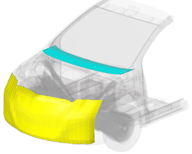

Figure 6. Construction Lines and Spheres - Front and gap tape components that are used to close the openings at the front of
the vehicle and in the gap between the windshield and hood:
Figure 7. Front Tape and Gap Tape - Impact points for the selected load cases (Headform, Upper-Leg, Lower-Leg). The
impact points are stored as design point entities in the Model Browser. Each impact point has its own graphic and name defined
as per the regulation protocols.
Figure 8. Front Tape and Gap Tape

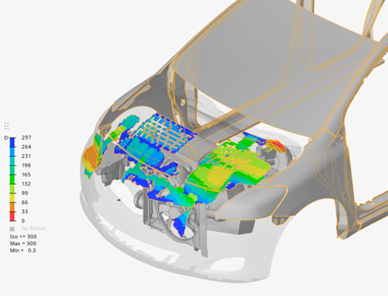

Hard Parts

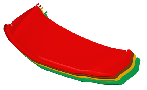

The Hard Parts tab allows you to plot a distance contour distribution of Hard parts on the Vehicle outer and determine package space detection.
Hard Parts Contour: Identify critical areas of impact for the head and leg.
Vehicle Outer: Select Vehicle Outer parts.
Hard Parts: Select hard parts to consider for distance contour.
- Adult Child Headform
- Upper Leg
- Lower Leg
Max length: Distance value to be considered for contouring.
Impactor Angle: The angle value that will be considered at which computed distance of Hard parts will be projected to Vehicle Outer.
Project direction: For Headform projection direction this can be set to Up (on hood) or Front (on bumper).
Contour: Plot the distance distribution as contour.
Figure 9. Headform Hard Parts Contour
Clear: Clear the created contour.

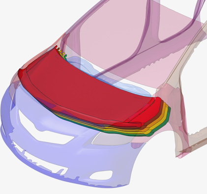

Offset Zones/Package space detection: Using offset zones, you can identify critical areas of impact for the head and leg.
- Adult Headform
- Child Headform
- Upper Leg
- Lower Leg
Offset Zone distance: Distance values for each of the colored zones.
- Impactor File Type: Select either Impactor File or Impactor Skin File.
Figure 10. EuroNCAP Child Headform Zone Offsets
Figure 11. Child Headform Zone Offsets Transperancy
Hide: Transparency is reversed for all parts.
Delete All: Delete all of the created offset zones.

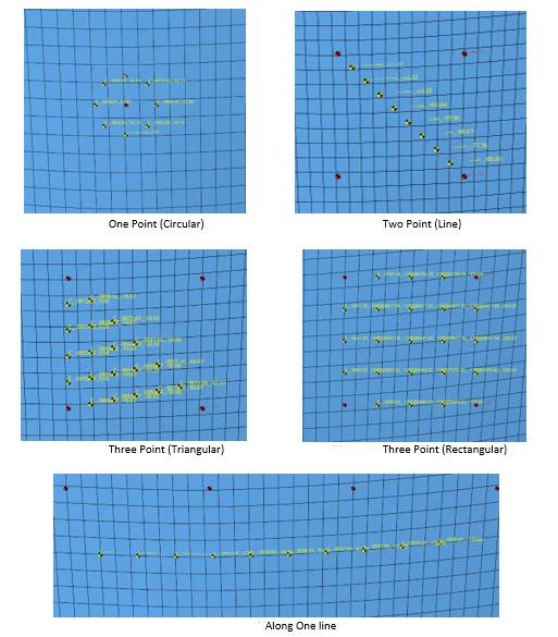

- Headform:
- Array type: Types of refinement selection.
- One Point (Circular)
- Two Point (Line)
- Three Point (Triangular)
- Three Point (Rectangular)
- Along One Line
- Between Two Lines
- Clearance: Distance value to be considered for local refinement.
- Radius: If Array type = One Point (Circular), define the distance value for the circle radius.
- Points to create: Number of local refinement points to be created.
- Headform:
- Create: Generate refinement points.
- Delete All: Delete all of the local refinement points.

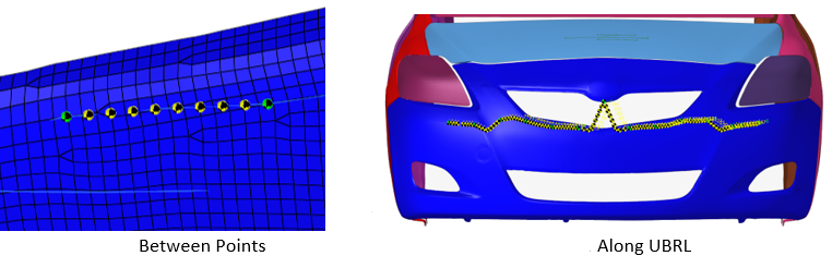

Figure 12. - Lower Legform:
- Array type: Types of refinement selection. Select Between Points or Along UBRL.
- # Points to create: The number of local refinement points to be created.
Figure 13.

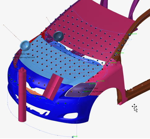

- Preview: Preview selected points at Impact Points table.
Figure 15. All Four Impactors Previewed - Cleanup: Delete all positioned impactor skins for preview.

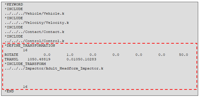

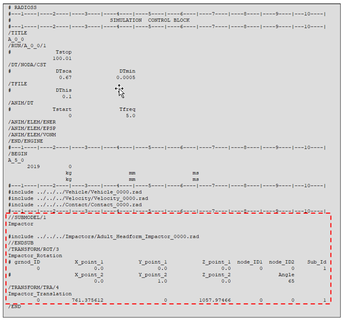

- LS-DYNA
- The impactor include file is defined as an *INCLUDE_TRANSFORM and the
*DEFINE_TRANSFORM cards are automatically generated and assigned to the
*INCLUDE_TRANSFORM.
Figure 16. - Radioss
- The impactor include file is defined in a //SUBMODEL and the /TRANSFORM cards are automatically generated with reference to the impactor sub model.
