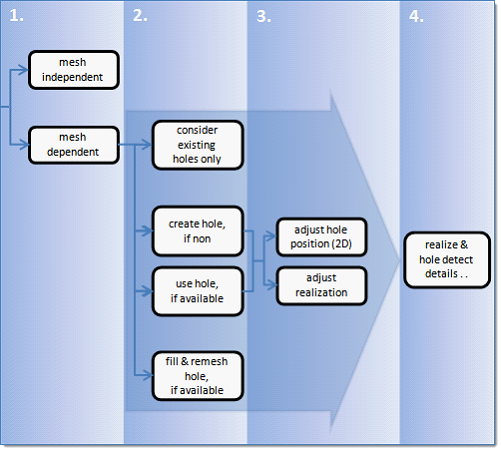

Bolt Realization Process
Overview of the bolt realization process.
- Select the realization type.
- mesh independent
- Use for realizations which do not need a node connection, and the connection is primarily defined via a solver-specific card or the nodes which need to be connected are defined by a cylinder, such as Bolt (cylinder spring) for Radioss.
- mesh dependent
- Use for all other cases.
- If you selected mesh dependent, you must determine:
- Is the existence of holes in each layer requested upfront?
- How should the 2D mesh be prepared before the final realization is performed?

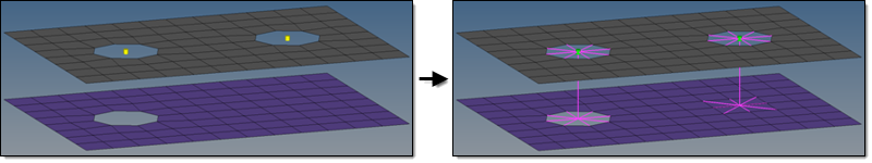

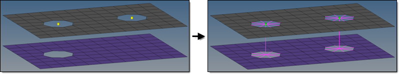

Select one of the following:- Consider existing holes only
- A minimum of one hole per layer must be available in the
origin mesh. If holes do not exist the realization will
fail. This is the default method and must be used for any
type of solid meshes.

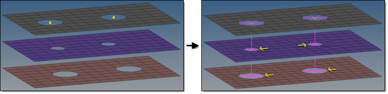

Figure 3. Consider Existing Holes Only - Create hole, if none

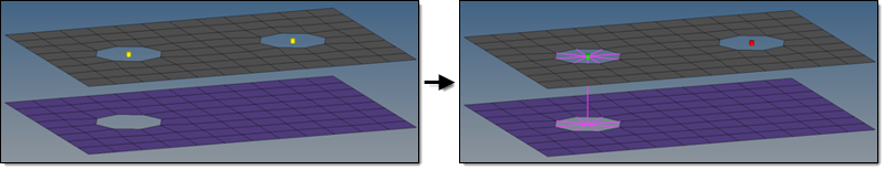

- If there are not any holes on a certain layer, they will be
punched into that layer at the position of the projection
point. The diameter of the new hole is defined on the
Realization Details subpanel. This method is used if the
model does not contain the appropriate amount of holes per
bolt, but holes are required for specific realization
types.

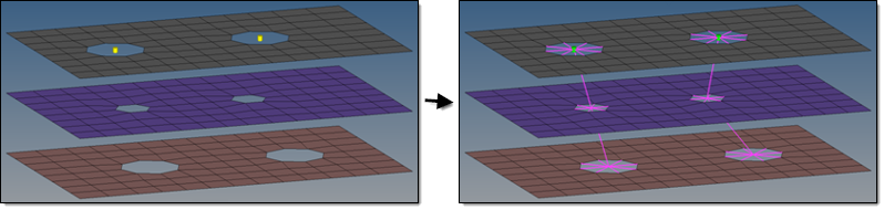

Figure 4. Create Hole, if None - Use hole, if available
- Creates hybrids (hole on one side only), but other
combinations are allowed. On the mesh side (no hole), the
connection is realized via the head elements defined in the
chosen realization type. The head element(s) is/are created
between the appropriate body element node and the nodes
inside the diameter (no hole connection dia) defined on the
Realization Details subpanel. This option is used for
realization types which are not eager for holes.

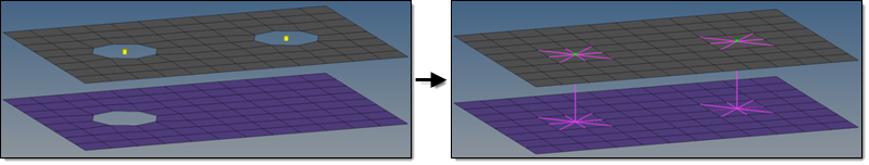

Figure 5. Use Hole, if Available - Fill & remesh hole, if available
- Use this option when you do not want the shape of holes to
interfere with the mesh flow in the bolt region. The
detected holes are closed and a remesh of the new elements
and a few additional rows of adjacent elements is performed.
The connection is realized via the head elements defined in
the chosen realization type. The head elements are created
between the appropriate body element nodes and the nodes
Figure 6. Fill & Remesh Hole, if Available

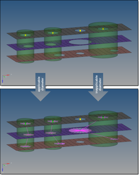

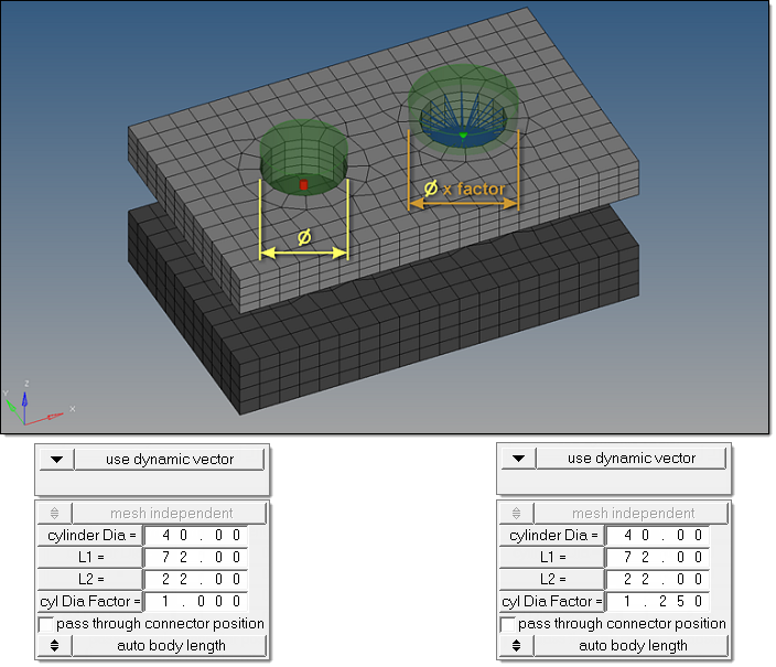

Note: The hole detection mechanism for the last three options takes into account a cylinder which is defined in the Hole Detection Details subpanel. The hole consideration cylinder option can be defined as a factor of the no hole connection dia option or as an exact diameter. Principally holes which are inside or touching the cylinder can be detected, but the hole consideration is reduced to one hole per link per connector. Additionally holes need to fit to the requested dimensions, which are also defined in the Hole Detection Details subpanel. - For the create hole, if none, and use hole options, a mesh modification

- This stage cannot be skipped, as it has great influence on stages 2 and 3,
which is expressed by the large arrow underlying those stages in the flow
chart.
This stage contains all realize and hole detection details which need to be known before the final realization is done. The realize and hole detection subpanel can be accessed by clicking realize & hole detect details in the bolt and realize subpanels. This subpanel is organized into two additional subpanels: hole detection details and realization details.
Figure 9. Bolt Realization Process
- Dimension and Feature Angle
- The minimum and maximum dimensions define which holes should be considered during bolt realization. The minimum and maximum feature angle define the features to be considered as hole edges for solid elements.
- Hole Consideration Cylinder
- Not all of the holes found in the given connector tolerance can be considered for
the various bolt realizations.
- The connector tolerance, especially when set to a large value, detects many holes. To prevent detecting holes which are far away from the connector position and are not aligned with the other hole(s), the consideration cylinder excludes outer holes from the detection.
- Since the existence of a hole is not necessarily requested anymore, a space has
to be defined where the holes are expected to be. It is no longer sufficient to
use just the connector tolerance, therefore the hole consideration
cylinder option performed along the projection path becomes
necessary. All of the holes the cylinder touches or contains can be considered for
Figure 10. Hole Consideration Cylinder
