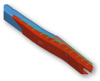

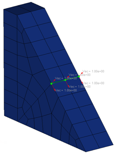

Connectors are geometric entities (not FE) used to create connections between components. Connectors are used to realize
FE idealizations of the physical connection. Just as you create an FE mesh on a surface, you create FE connections
by realizing a connector.
There are many advantages to the way connectors store information. Not only does this local storage allow you to edit
the connector definition, it also allows you to review connector details and the quality of the realization.
Most of the information stored in the connector entity can be exported to a master connectors file, which contains
connector entity information such as location, link entity, link entity state, link entity rules. The exported file
may also contain metadata information stored in the connector.

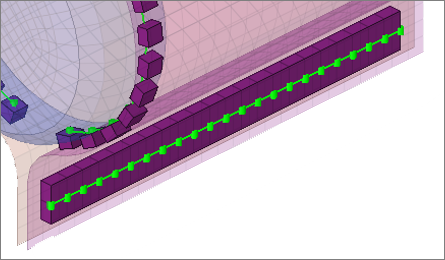

Create weld points at a predefined pitch distance so that the model build process can continue without the need to
wait for the published weld data from CAD. Autopitch is useful when working with elements, not geometry.

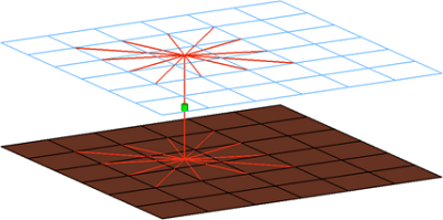

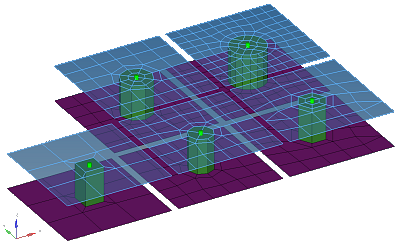

Creates hexa element with DCOUP3D elements projecting and connecting to the
surrounding shell elements. This realization uses the shell thickness to calculate the
hexa offset from the shell elements. In the case where the model is a 3T connection, the
acm (equivalenced-(T1+T2)/2) realization will join the hexa elements.
This realization uses the prop_abaqus_acm.tcl4 property script. Figure 2.

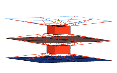

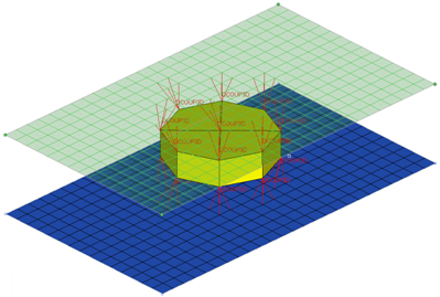

Creates DCOUP3D elements for the head and element for the body. The head elements
project and connect to the nodes of the adjoining shell elements. Figure 3.
Creates KINCOUP elements for the head and element for the body. The head elements
project and connect to the nodes of the adjoining shell elements. Figure 4.

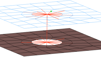

Creates KINCOUP elements for the head and B31 element for the body. The head elements
project and connect to the nodes of the adjoining shell elements that form the hole, and
also to the second row of nodes to form the washer layer. The connector location can be
on the edge of the hole, center of the hole, midpoint in between the two, holes or on
the second row of nodes which form the washer layer.
This connector also uses the script prop_abaqus_b31.tcl3. Figure 5.

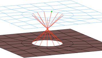

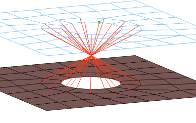

Creates a KINCOUP element. The element projects and connects to the nodes of the
adjoining shell elements that form the hole, and also the nodes that form the washer
layer. The connector location can either be on the edge of the hole, center of the hole,
midpoint in between the two holes, or on the second row of nodes which form the washer
layer. Figure 9.

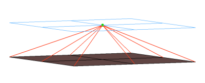

Creates a KINCOUP element, which projects and connect to the nodes of the adjoining
elements which form the hole. The connector location can either be on the edge of the
hole, center of the hole, midpoint in between the two holes, or on the second row of
nodes which form the washer layer. Figure 11.

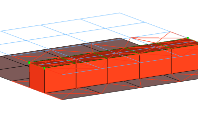

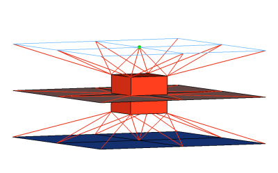

Creates a hexa element with DCOUP3D elements projecting and connecting to the
acm (detached-(T1+T2)/2) realization will not join the hexa elements.
This realization uses the prop_abaqus_acm.tcl4 property script. Figure 18.

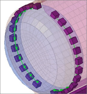

Creates one hexa cluster per connector and realizes a node to node connection to the
linked shell meshes by adjusting it (shell coating). Different patterns are available.
This is driven by the number of hexas. The appearance can be influenced via the diameter
and the washer layer activation. Figure 20.

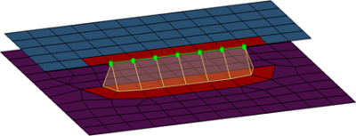

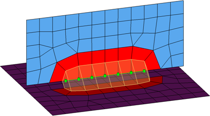

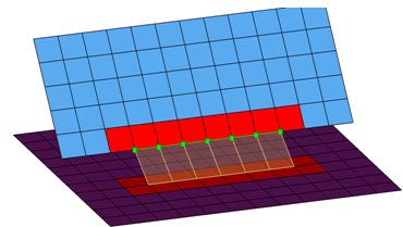

Creates a quad row with tria caps at the seam ends. In addition, a certain pure quad
element pattern is created around the seam elements, shown here in red. These elements
normally get imprinted into the shell links. The exact geometry of the seam can be
influenced by certain attributes in the Seam panel.
This realization is mainly intended to be used for lap welds.
Note: You can revert the
direction of quad seam connectors during the next realization by activating the
reverse direction checkbox in the Seam panel.

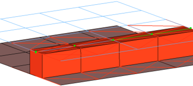

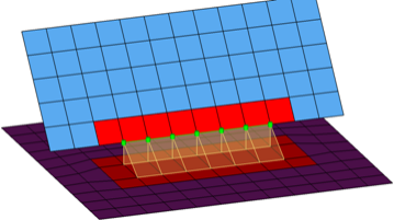

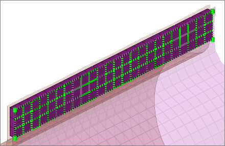

Description: Creates two quad rows-the first one perpendicular to the opposite shell
link, and the second one with a certain angle to the first one. In addition, a certain
pure quad element pattern is created around the seam elements, shown here in red. These
elements normally get imprinted into the shell links. The exact geometry of the seam can
be influenced by the angle value.
This realization is can be used for both lap- and T-welds.

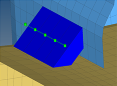

Creates one quad row under a certain angle. The angle is measured between the quad row
and the perpendicular projection from the free edge to the opposite shell link. In
addition, a certain pure quad element pattern is created around the seam elements, shown
here in red. These elements normally get imprinted into the shell links. The exact
geometry of the seam can be influenced by the angle value.
This realization is can be used for both, lap- and T-welds.

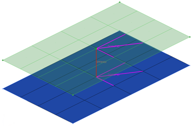

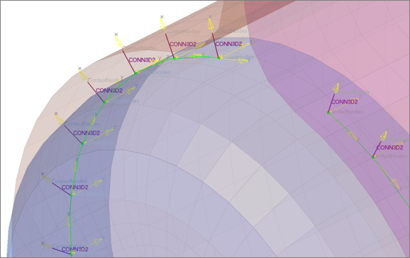

Creates SPRING elements for the body, and projects and connects to the adjoining
shell/solid elements with DCOUP3D elements.
The realization uses the prop_mastic.tcl2 property script. Figure 26.

elements. The hexa elements are projected so that they touch the shell/solid elements of
the connecting components.
This realization also uses the prop_abaqus_acm.tcl4 property script. Figure 27.
Creates perpendicular and parallel vectors to the surface along a line/nodelist. On
exporting the connector file, a vector file (.asc format)
containing the vector information is also exported for this realization. Figure 28.
