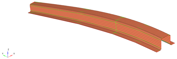

- Tapered hat mesh and geometry
- Structure with combination of unidirectional carbon fiber and woven fiberglass plies

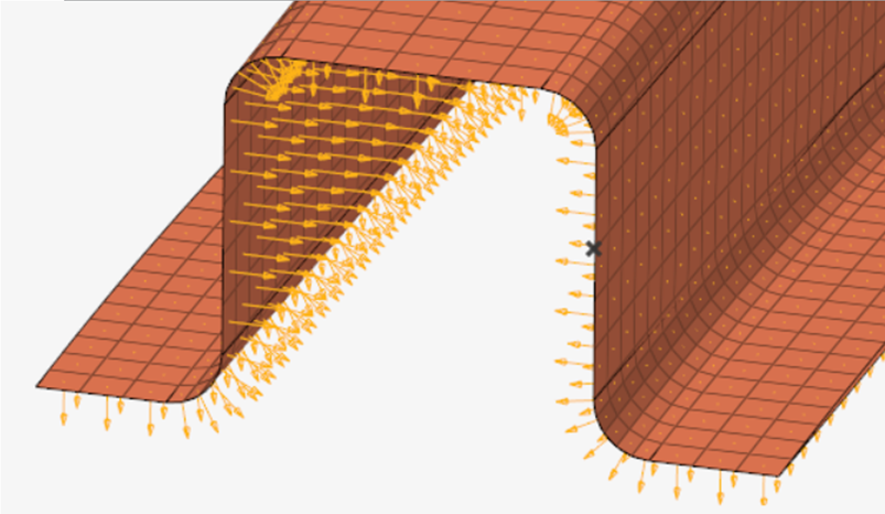

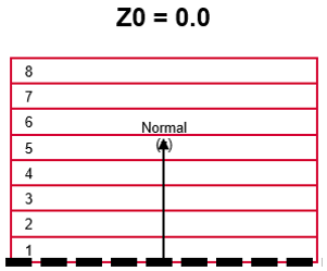

Define Stacking Direction
Define the stacking direction of plies in the laminate.

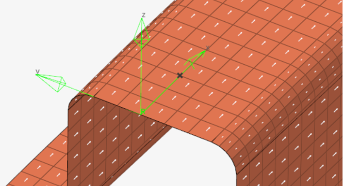

Material Orientation
Define the material orientation for the part.

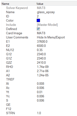

Material Creation
Review materials.

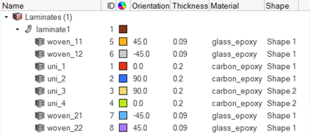

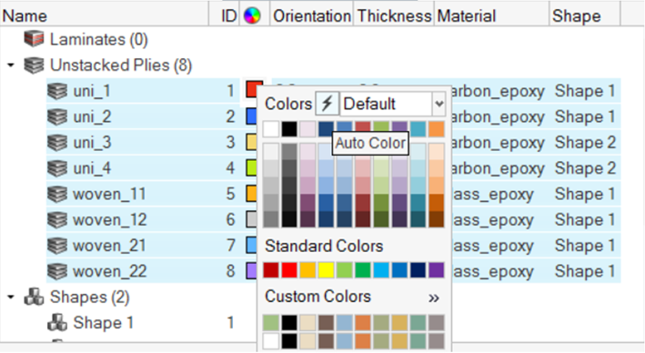

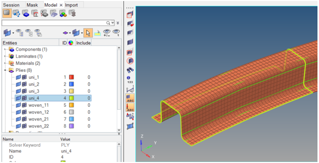

Ply Creation
Create the plies that make up the composite laminate.
Laminate Creation
Create the laminate and stack the plies.

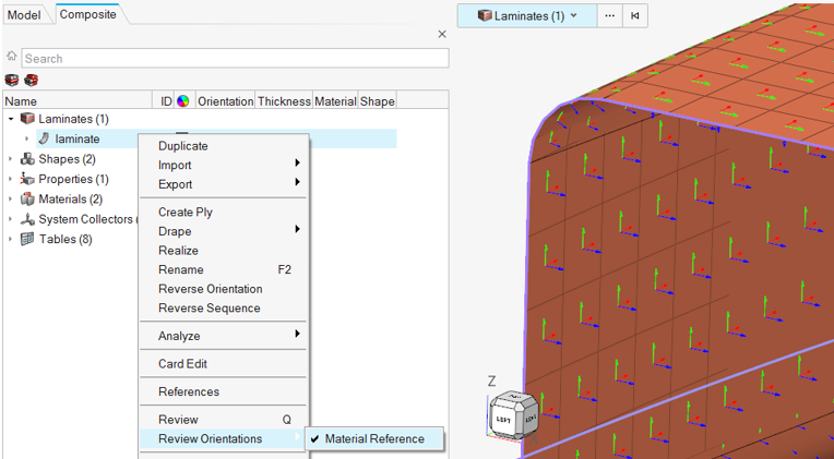

Material Reference Orientation Visualization
Plot vectors that represent the x,y,z reference orientation of each element.

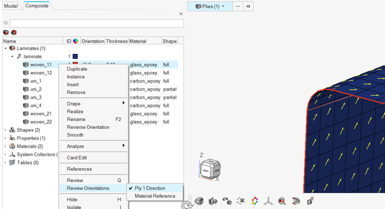

Ply Direction Visualization
Plot vectors that represent the ply 1 directions on each element.

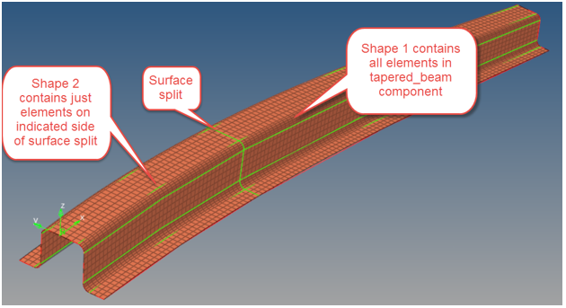

Ply Shape Visualization
Plot the boundaries of each ply.
If you are using HyperWorks, select one or more plies in the Composite Browser. The boundaries of the ply will be drawn automatically. Otherwise, follow the steps below.

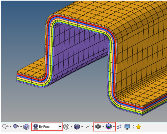

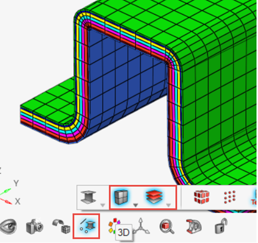

Thickness and Layers Visualization
Visualize the thickness and ply layers of the laminate.
In HyperWorks:
In HyperMesh Desktop:

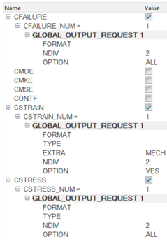

Optional: Result Requests
Request typical composite results from OptiStruct.

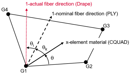

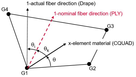

Optional: Draping
Perform a draping simulation to account for local orientation changes in each ply due to placing material on a tool with compound curvature.

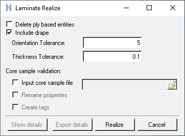

Optional: Laminate Realization
Generate zone-based solver properties from the ply-based model.
This step is typically performed at the end of a model build for solvers other than OptiStruct because ply-based cards are not supported. OptiStruct directly supports ply-based composite analysis.
