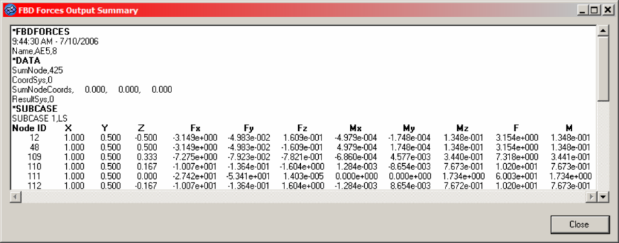

To output the results to a popup window for instant review, select the
Show summary table checkbox.
The table contains information about the loadsteps, element set(s), and detailed data from the grid point extraction at each node.
Figure 1. -
