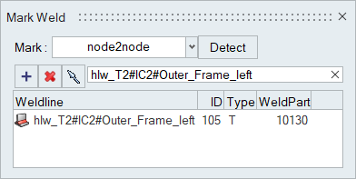

Add a Weld Line Manually
Click the Mark Welds tool.
Figure 6. The Mark Weld dialog opens. -
Enter hlw_T2#IC2#Outer_Frame_left in the search text box and
press Enter.
Figure 7. -

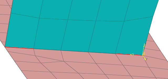

Right-click on the weld line and select Isolate > Weld + Comp from the context menu.
The weld line and its attached components are isolated in the modeling window.
Rotate the model and zoom in closer to view the weld line
clearly.

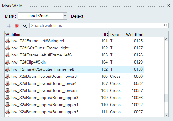

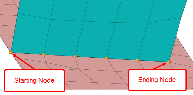

In the Mark Weld dialog, click
An entity selector appears. -
Select the starting and ending nodes of the weld path as shown in the image
below.
Figure 9.The nodes in between the starting and ending nodes should be selected automatically. -
Click OK in the Advanced Selection
dialog then click
on the entity selector.
The newly created weld line is displayed in the Mark Weld dialog.
Figure 10.The weld line is also added to the WeldLines folder in the HyperLife Model Browser.

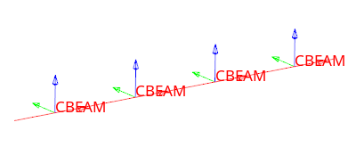

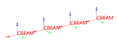

Figure 11. - Again, right-click on hlw_T2#Frame_left1#Frame_left7 then select Rotate Y > All.
The direction of the weld line segments are rotated, but the change is not
immediately apparent. In order to see the rotation, right-click on the weld line
name once more and select Isolate > Weld + Systems.
Figure 12. - Right-click on any weld in the dialog and select Show All to return to the full model view.

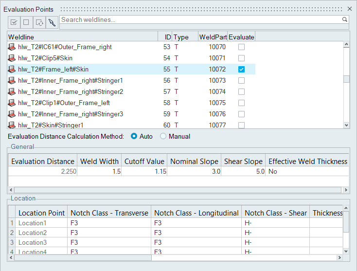

Review Evaluation Points
Click the Points tool.
Figure 18.The Evaluation Points dialog opens. -
Select hlw_T2#Frame_left#Skin from the weld line list.
Note: The Evaluate checkbox should be activated. Any weld lines that are marked as critical in the screening process are automatically selected in the Evaluation Points dialog.
Review the classification parameters.
The classification parameters for each weld vary depending on the weld type and the weld regulation selected.
Figure 19. - Review other weld lines at your own discretion then exit the dialog.

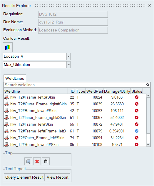

Evaluate and View Results

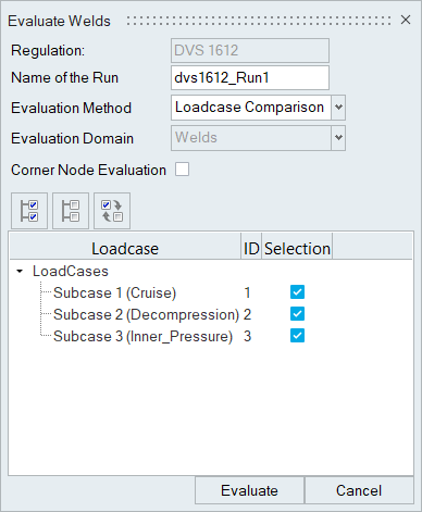

From the Evaluate tool group, click the
Run Analysis tool.
Figure 20. The Evaluate Welds dialog opens. - Optional: Enter a name for the run.
- Select Loadcase Comparison for the evaluation method.
Ensure that all three load cases are selected.
Figure 21. -
Click Evaluate.
A summary of the run appears.
Click OK to close the dialog.

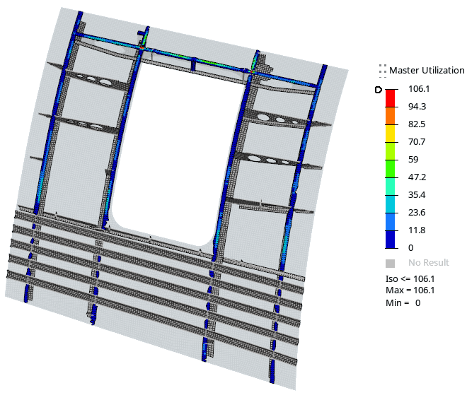

The Results Explorer opens and the model is contoured.
Figure 22. -
In the Results Explorer, select
Location_4 from the first drop-down menu and
Max_Utilization from the second drop-down menu, then
click
Figure 23. -

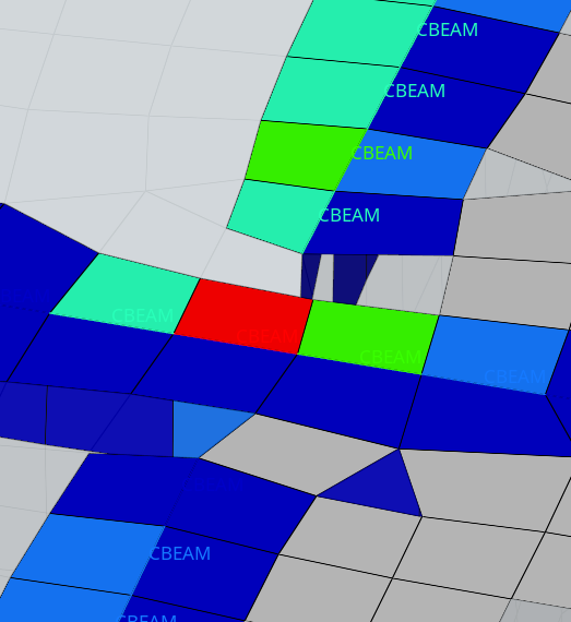

Zoom in on the model to view areas of interest.
Figure 24. -
Add tags to elements.
Under the Tag field of the Results Explorer,
click
- Select elements to tag.
Click
on the
entity selector.
The selected elements are tagged with IDs and utilization values.
Figure 25.
