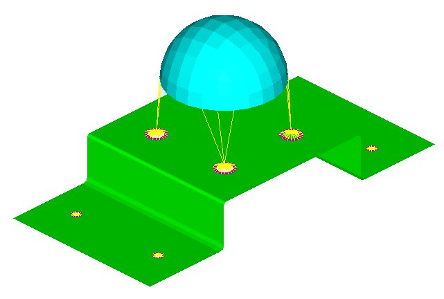

- Import a model to HyperLife
- Check that the FE result file contains a frequency response function (FRF) subcase with element stresses

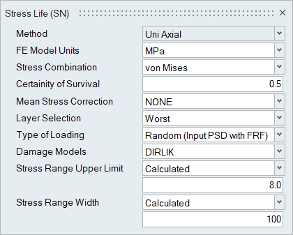

- Select the SN module with a Random (Input PSD with FRF) loading type and define its required parameters

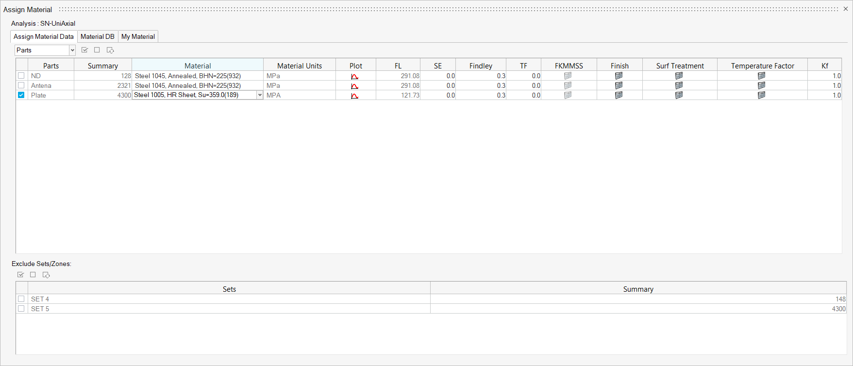

- Create and assign a material

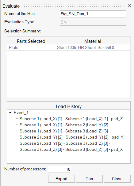

- Create a random fatigue event with Input PSDs

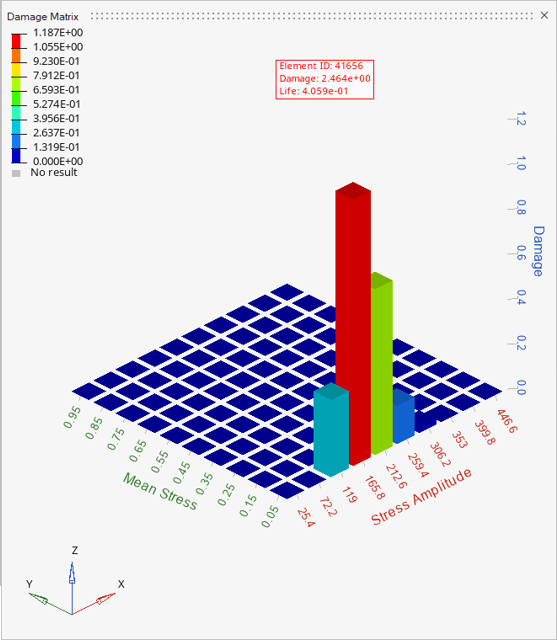

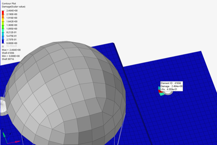

- Evaluate and view results
