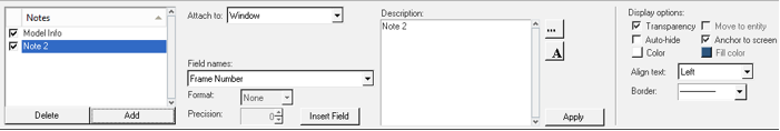

The names of all the notes in the active window are displayed in the Notes list. You can add and delete notes from the list. Check boxes allow you to display one or more notes. You can also sort the items in the Notes list by clicking on the list heading. In addition, keyboard shortcuts and a context menu are available for items within the list.
Figure 1. Notes Panel
