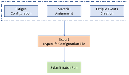

Export Batch Run
Use the Batch tool to run submission in batch.
Figure 1. Fatigue Analysis Setup
From the Evaluate tool group, click the
Run Analysis tool.
Figure 2.The Evaluate dialog opens. -
In the Evaluate dialog, click
Export.
A folder containing the xml file is created for the run at Fatigue/runhistory.
Create a batch job.
From the Utilities tool group, click the Batch
tool.
Figure 3.The Batch Run dialog opens.
tool.
In the Batch Run dialog, click
and
browse for the previously created xml file.
Click Submit Run.
A run log file (*.log) containing information about the run setup and status is written to the run folder.
Analyze the log file.
