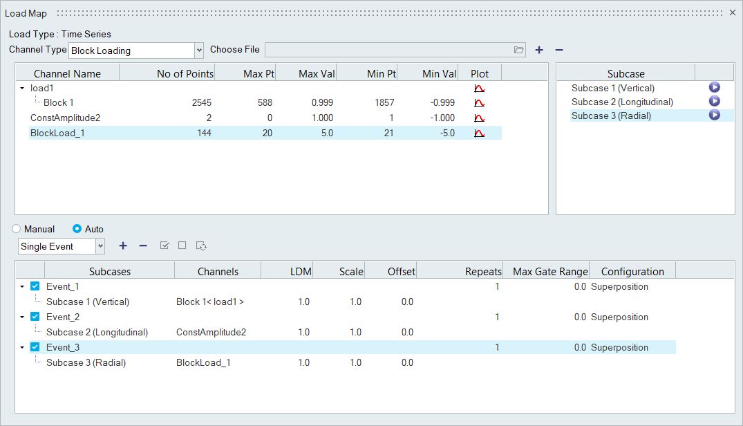

Create Time Series Events
Figure 5.
- Results stress tensor at time t
- Stress tensor from static analysis
- The y point value of load-time history at time t

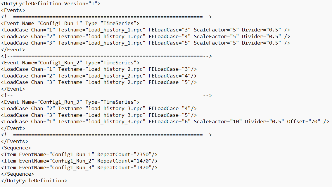

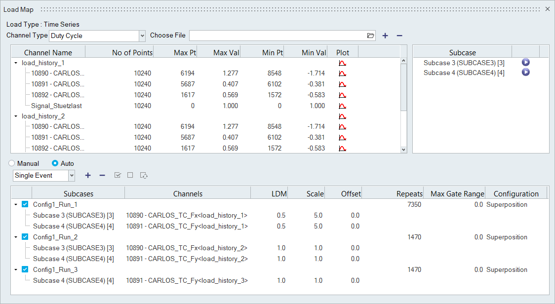

Create Duty Cycle Events
HyperLife facilitates in importing Duty Cycle files (*.dcy) which have complex duty cycle information for multiple durability events.
Duty Cycle is supported for all fatigue calculations with a Time Series loading type.

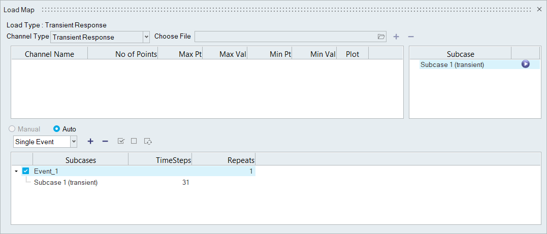

Create Transient Response Events
Figure 10.

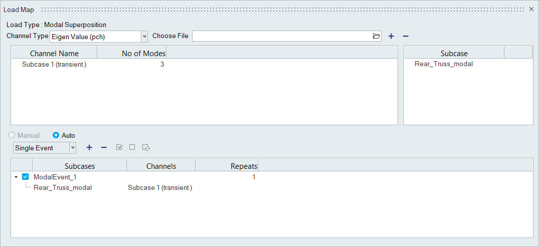

Create Modal Superposition Events
Modal subcases are supported for SN (uniaxial, multiaxial) and EN (uniaxial, multiaxial) fatigue calculations with a Modal Superposition loading type.
Figure 12.
- Stress history for the given time interval of an element
- Participation factor per mode at time t (via mrf/pch file)
- Modal stress of an element per mode (via an h3d or
op2 file)Note: op2 files are only supported for mrf channels. h3d is supported for both mrf and pch.
- Mode

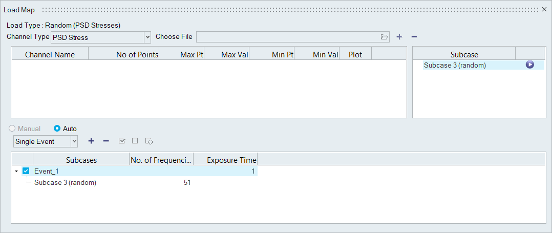

Create Random (PSD Stresses) Events
Random Response subcases are supported for SN (uniaxial) and EN (uniaxial) fatigue calculations with a Random (PSD Stresses) loading type.
Figure 14.
