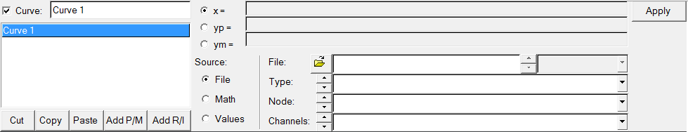

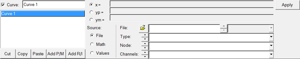

File as a Data Source
If File is selected as the source, the file panel is displayed, allowing you to select data files for the X, Y, and Y2 vectors.
Figure 3. File selected as the data source for a vector

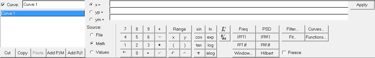

Math as a Data Source
If Math is selected as the source, the curve calculator is displayed, allowing you to define the vector mathematically.
Figure 4. Math selected as the data source for a vector

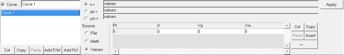

Values as a Data Source
Figure 5. Value selected as the data source for a vector

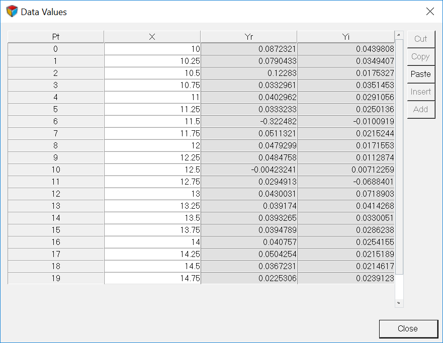

You can cut, copy, paste, and insert data point values to the table. Click the
expansion button,
, to view
a larger dialog containing all X, Y, and Y2 data points.
Figure 6.
