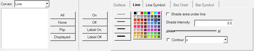

Line Attributes
Line thickness can be assigned to a curve. The line weight for each curve is displayed in the legend. Click on a line weight to change the thickness of the currently selected curves.
Any of the 64 colors can be assigned to a curve. Select a color from the color palette to change the color of the selected curves.
- Shade area under line
- Fills in the area under the curve line with a solid color.
- Shade intensity
- If you select Shade area under line, you can determine the shade intensity by either entering a value directly or using the slider bar.
- Contour
- Click Contour and define the contour values by entering a math expression to define contour values. You can use the default X, Y, Z selections or use your own math expression.
