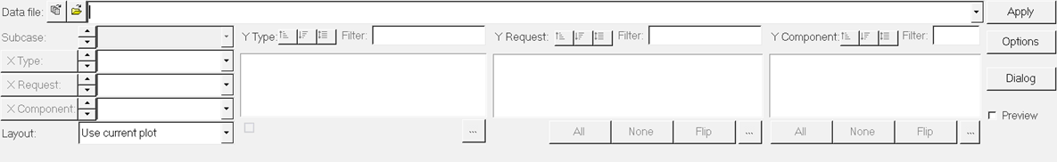

Build Plots
Constructs multiple curves and plots from a single data file.
- Subcase
- Select a subcase by using the
buttons to scroll through the types of data
in the open file or clicking the down arrow to expand the list. - X Type

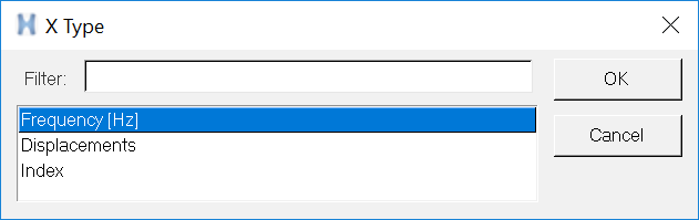

- Y Type
- Select the data type for the X vectors.
- X Request
- Y Request
- Request Filter
- Once the data type has been selected, the data request set needs to be
selected. To do this, use the buttons to scroll through the requests or
click the down arrow to expand the list for X Request. Or, click the
button to launch the Y Request filter. This
filter contains the same selections as the Y Request list and the X
Request drop-down menu. - X Component
- Y Component
- Component Filter
- To select the data component, use the buttons to scroll through the X
Component options or click the down arrow to expand the list. Or, click
the
button to launch the Y Component dialog.
This dialog contains the same selections as the Y Component list and the
X Component drop-down menu. - Sorting Type, Requests, and Components
- Click
to sort the data in ascending order.
Layout Options

For all plotting options, a new page is created. The layout of the new page can be selected from the page layout button on Build Plots. When the plots are built, each window on the new page is filled. If more windows are required, another page of the same layout is created.
- Apply
- Click Apply to construct all the curves at
once.
The program automatically generates axis labels, plot titles, and page names. They can be edited using the Axes and Title panels and the Page List dialog.
