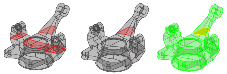

Review the split sections.
Restriction: Only available when splitting solids.
- Activate the Extend trimmer option.
Click the Review button on the guide bar.
The split sections are previewed, as shown below on the left. Deselect sections by holding Shift and left-clicking to cut the solid at only the desired locations, as shown below in the middle. The final result is shown on the right.
