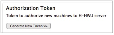

Once you have a valid Altair Connect account, you should be able to see the HAU or Hosted Units menu on the left-hand side. There are both administrative functions (if you are one of your company's designated admins) and user functions. This section will cover the typical user functions. The two main functions are authorizing a machine to use HAU and checking on current usage.

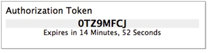

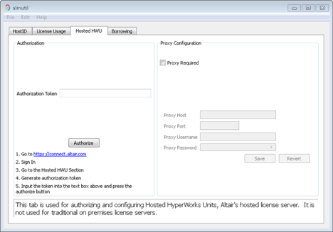

In order to utilize the HAU system and your purchased units, each machine you wish to use your units from must be authorized prior to running any client applications. This is a two-step process.

- Usage: almutil [option]
- -hhwuauth [-system -code <code>]
- Authorize with the Hosted Altair Units system.
- -proxy [-system -host <host> -port <port> -user <user> -passwd <passwd>]
- Configure proxy settings for use with the Hosted Altair Units system.
