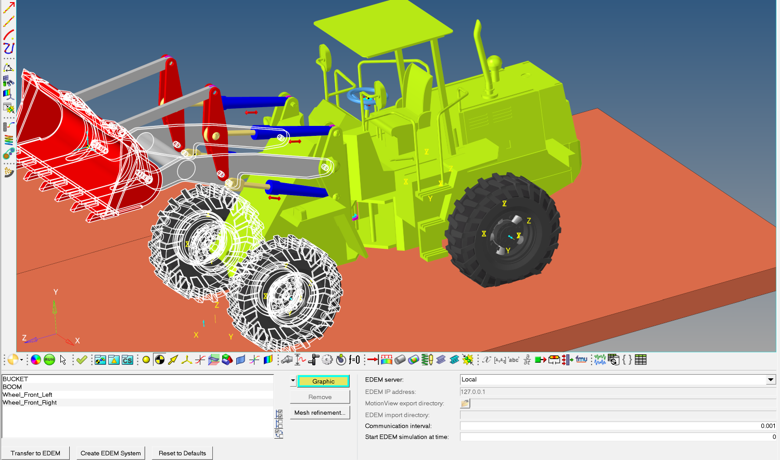

The EDEM subsystem tool defines the co-simulation settings between MotionSolve and EDEM. Within the tool, you can:- Transfer graphics from MotionView into EDEM. Note: This is particularly useful in cases where the model contains a large number of components, such as a chain drive. This resolves the need to remodel the same components in EDEM. MotionView generates an STL in the background and transfers to EDEM through an EDEM Coupling server.
- Choose if EDEM runs locally or on a separate server.
- Define the communication parameters if EDEM runs on a separate server.
- Define simulation settings, such as the communication interval and simulation start time of EDEM.

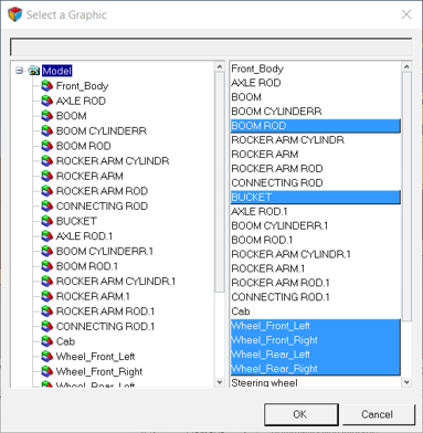

- Activate the Graphics collector or the
Body collector and pick the graphics/body that will interact
with the bulk material in EDEM. When selecting using the Body collector, all valid
graphics associated with the body will be selected. Graphics of type Box, Cylinder,
Sphere, Ellispoid, CADGraphics, FileGraphics can be selected from the graphics area.
Note: Use the Body collector to select a flex body (CMS).Tip: Use the Select a Graphic/Body dialog to pick multiple graphics simultaneously (double click on the collector to display this dialog).
Figure 3. Select a Graphic DialogNote:- This functionality currently supports the following graphics: Box, CADGraphic, Cylinder, Ellipsoid, File (mesh-based graphics such as H3D/OBJ) and Sphere. Any other type of graphics selected using the Advanced Graphics selector dialog will not be used and a warning message will be displayed.

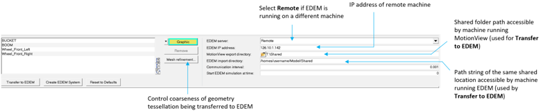

Maximum facet width ratio Maximum width of elements in meters. Curve chord tolerance factor Tolerance factor that controls chordal deviation along curved edges. Surface plane tolerance factor Tolerance factor that controls surface deviation along curved surfaces. - Select the EDEM server:
- Local if EDEM are running on the same local machine as MotionView and MotionSolve.
- Remote if EDEM is running on a different machine.
- EDEM IP address - Specify the IP address of the machine where EDEM application is running. Default is set to 127.0.0.1 which refers to the local machine.
- MotionView Export directory – This is applicable only for transferring geometry to EDEM on a remote server. Select a shared directory which is accessible by both machines. MotionView will use this directory as a temporary location to transfer the geometry.
- EDEM Import directory – Path string of the same shared directory as above but as recognized by the machine running EDEM.

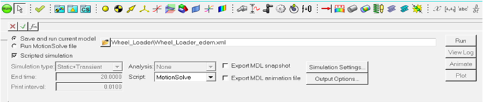

Once the model is defined, the solution process is identical to performing a “MotionSolve-only” simulation.
Use the Run Solver panel in MotionView/MotionSolve to start the simulation. MotionView will launch MotionSolve.

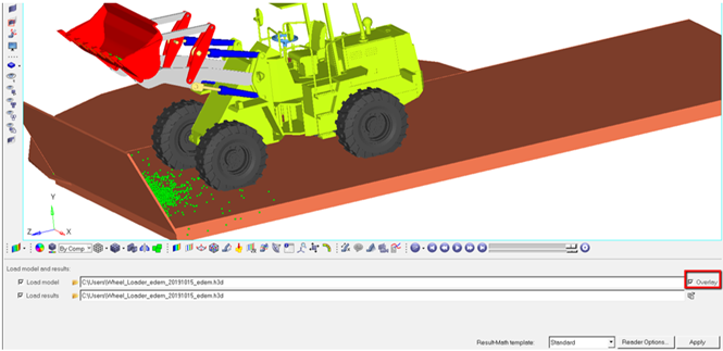

- Use the Animate button in the MotionView Run panel to load the MotionSolve H3D into a HyperView window.
- Overlay the EDEM H3D in HyperView using the Overlay option in the Load Model and Results panel to visualize the entire system in one environment.
